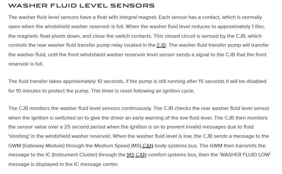

Well mystery solved... I figured Jaguar would know what they're talking about when writing their Workshop manual... guess not... The manual says the computer constantly monitors the level in the front tank and tops it up as needed. So, when I was testing the sensor, I figured when the sensor read "empty", the transfer pump would kick on. That is not the case. The transfer pump only kicks on when the windshield washer is operated. When I pressed the windshield wash button, the rear pump kicked on and transferred fluid to the front tank. Hopefully this helps someone in the future maybe messing around with the same issue...
