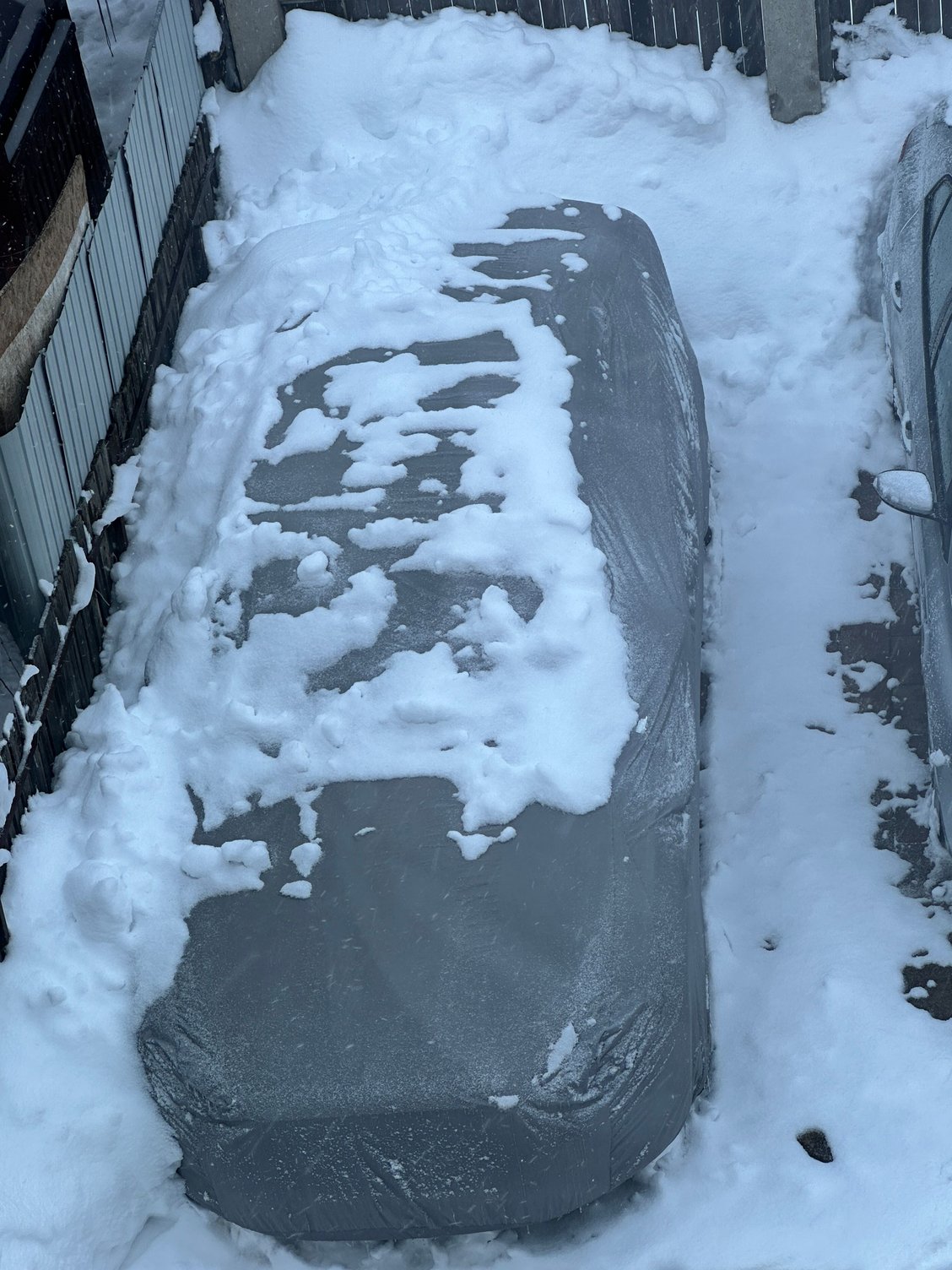

Hello guys.
because on the Last start 5-7 days ago…. Tha Jag flickered the screen at start, I want to buy a battery powered starter. You know….. The kind that's on battery, and you charge it at the socket and then use it on the car battery to help with the first start.
So…. My questions are:
What type. How many voltage? Amps or what?The start robot…. Connected directly to the +&- of the battery or could be the same under the bonnet at the engine?
The car started last time without help but the screen flickers for 2 seconds. So…. I am not in the battery dead case. Just want to help it at start a bit so it doesn't struggle. I am thi king that a couple of amps or volts extra would be helpfull.
I don't know how ow exaclywhat matter, amps or volts, so.….. Please educate me also on this ideea. So I can search for a good starter robot.
Ps: its gonna be a bit cold next few days….-14 Celsius.…. Will start the car after that. But the cold might drain a bit more the battery.
This is the situation right now. Snow and snow )))
Old Feb 18, 2025 | 11:56 AM
  #38
Carbuff2's Avatar
Joined: Aug 2018
Posts: 2,255
Likes: 930
From: Exit 30 in NorthWest NJ
On another board that I frequent, this item is held in high regard:
https://lithiumhub.com/product/emergency-start/
It allows you to jumpstart a car by Bluetooth if needed. NOT just for LI batteries.
No personal experience tho'.
Old Feb 18, 2025 | 12:16 PM
  #39
DJS's Avatar
DJS
Posts: 7,016
Likes: 2,687
From: Metrowest Boston
I purchased a Weego 44S jump starter, though I’ve never had to use it.
https://myweego.com/products/weego-44s
Old Feb 18, 2025 | 05:03 PM
  #40
OzXFR's Avatar
Posts: 9,025
Likes: 3,662
Maybe look at getting a NOCO jump starter.
I bought one a few years ago now and have used it three times so far on nephew's flat batteries and it worked a charm every time.
Engine fired up first crank each time on a dead flat battery.
One of the more basic and cheaper ones, this one: https://www.ebay.com/itm/12262509729...3ABFBM8p_AtKNl
That's the 1000 amp version which should be OK for an F-Type (never needed it or tried it on mine though) or you can spend a bit more and get a more powerful version, plenty to choose from.
