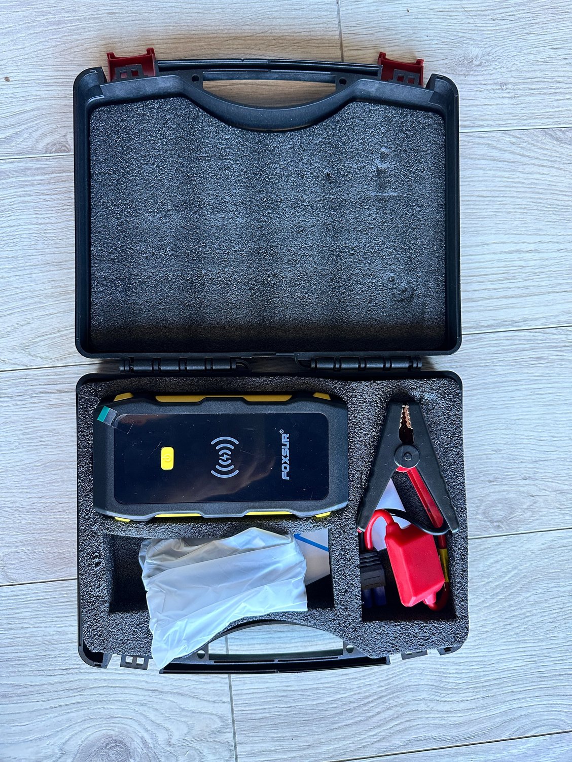

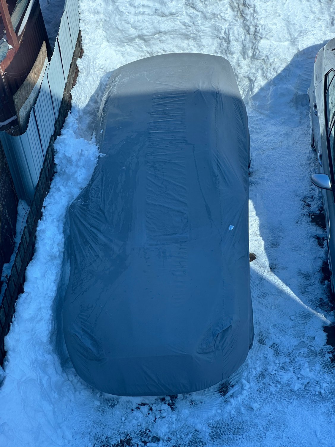

Thanks all the guys for all the answers.
i decided to go for a 800amps start power. For 4.0 petrol and 3.0 diesel. Basically….. A power bank with a protection and 2 battery clamps. And lantern. 60.000 power.
And after 2 hours of digging around…. All I could do is done.
Almoust all around clear. But I can move it…. Lift the cover and slide it out the rest

As a follow up
About 65 euro
….. Will test it soon.
Positives: really light! And compact. Hard case with foam on the Inside.
Minuses : made in prc. Seems…. Just like a normal power bank…. Except it's 60.000 charge capacity! Plastic galore)))
I looked at autodoc for some starting robots….. From about 230 euro and going up hard)))))) probably made in prc also. )))
Good for travel being compact. Wireless charge for phone. It charges by usb phones, tablets, …. Maybe MacBook! Go pro. Maybe drone battery! Also its a lantern.
