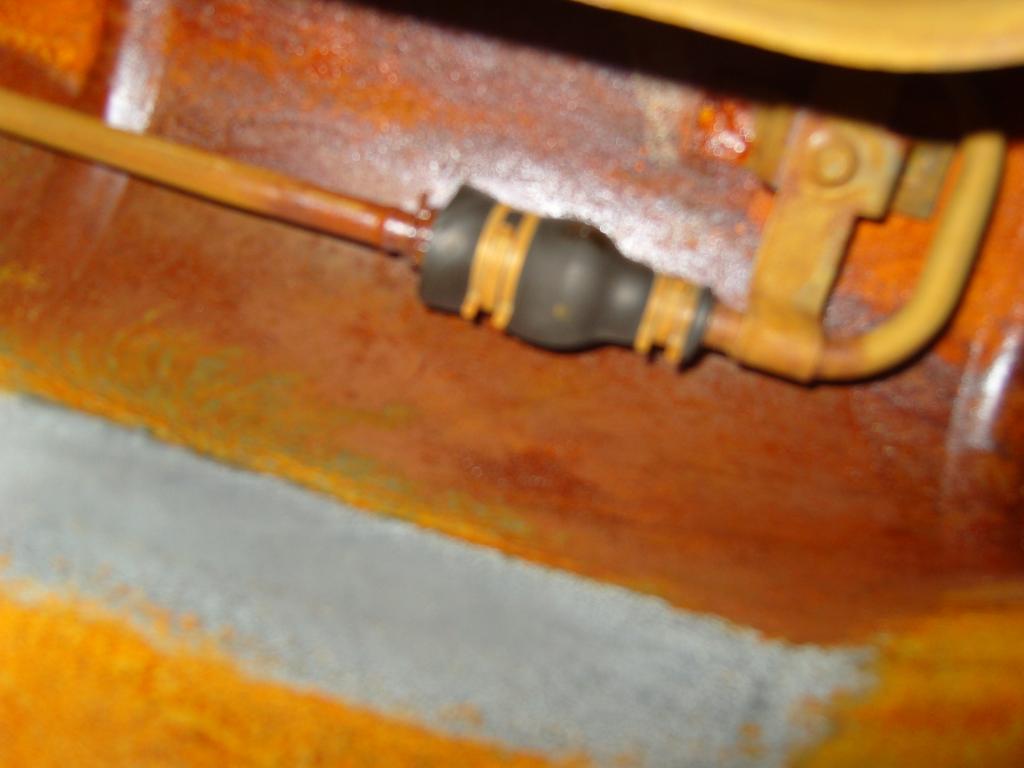

Default This is what Ethanol did to the Tank on my 95 XJS 4.0L Convertible!
My 1995 XJS 4.0L Convertible refused to Start one day, where eventually the problem was traced to a faulty Fuel Pump.
Not such a problem on most Cars, changing a fuel pump isn't 'Rocket Science' and can be done for the most part in just a couple of hours.
Not so on my 1995 Convertible XJS
Changing out the Fuel Pump was a nightmare!
The Fuel Pump sits in the 'Top of the Tank' and Fuel Tank had to come out!
The other problem being that its sits behind a Steel Baffle Plate, which is such a precision fit, that I had to remove all the Trim, just to get that out!
As well as the CD Changer, The Gas Struts and the Fuel pipes, which were very difficult to get to.
When I eventually got the Tank out, I looked inside and found it was rusted to hell, no doubt thanks to the Ethanol content of the Petrol.
As a result I had to have the Tank professionally Cleaned, followed by a New Fuel Pump and a New Sender.
All in all it cost me around £400 as I did all the work myself apart from the actual cleaning.
If I had taken her into a Garage, the cost would have probably been much nearer £1,000.
