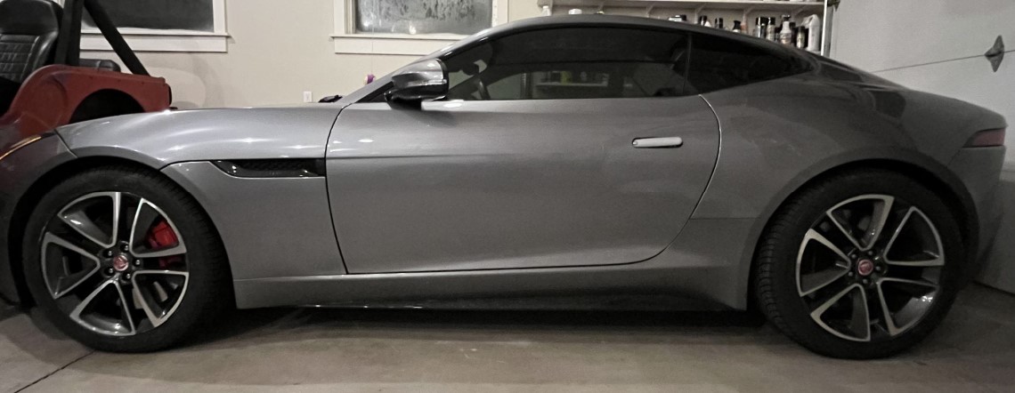

245/40/19, no spacer front, ~35mm spacer rear gets you oem look.
245/40/19, ~17mm front spacer, 50mm rear spacer gets the rims flush to the fender(reason for 17mm is 15mm might require some trimming of the original stud to fit and 20mm might rub)
245/45/19 will work with both of the above but a fuller looking wheel well (pictured), it’s a small 10mm difference on paper but makes a great visual impact.

The wheels you choose already have lower offset to accommodate the smaller width, they will sit the same as an oem 20” without spacer.
The spacer is recommended to bring your wheels flush to the fender to match the rear ( with 50mm spacer).
The spacer needed for rear oem look is about 35mm(with oem front wheels, bith 19 and 20”)
245 vs 255 is a very tiny difference once mounted, I’d base the choice on tire availability and price.
Do keep in mind my 245 rear with 50mm spacer has less than 5mm of clearance to the lip, i might be rubbing a bit with a 255.
tldr: get the 245

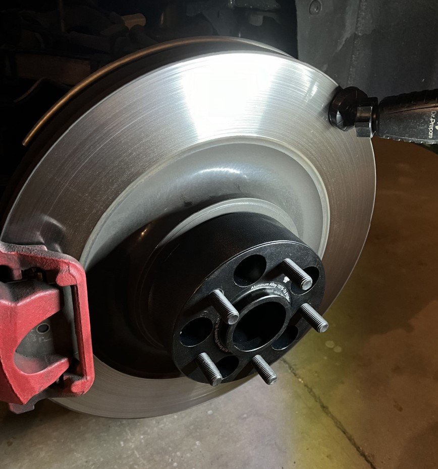

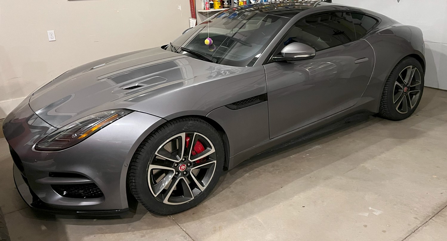

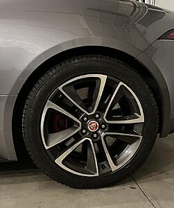

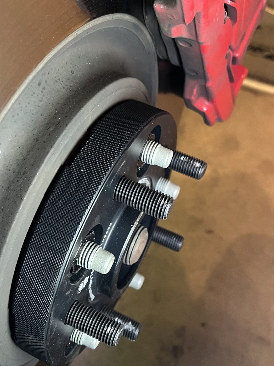

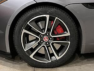

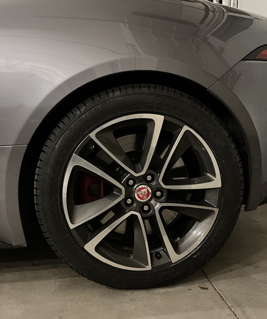

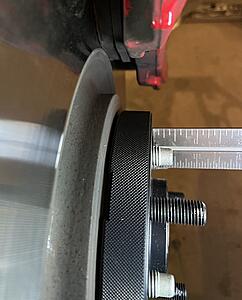

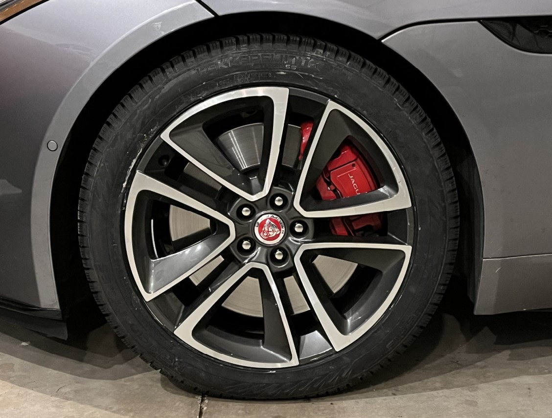

Well, it's been a month and I have an update on my winter wheels & tires journey.
- My four wheels arrived from the UK, each in a separate box and mostly on different days. Besides the 2-3 week delay and a couple more scratches than I expected, I'd say that the process and the cost were reasonable.
- I then bought the tires, the Nokian Hakkapeliitta R5 245/45 R19, and had them mounted to the new/gently-used wheels.
- And lastly, my Bonoss spacers 50mm (rear) and 20mm (front) arrived, and I was finally ready to put them all together and switch out the summer tires. The spacers came directly from China (which I did not know beforehand) and were made and shipped after I placed my order. I thought they were in stock, but instead the whole process took about 20 days for order to arrival.
Here's what I learned after going through the installation:
First, I learned that the front/rear support locations to jack up the car are not easy to find or intuitive. After some quick searches on my phone I felt confident enough about the general locations, but still really don't know exactly where the support points are. I jacked it up nonetheless and it seems to have turned out okay.
Second, I learned that the 20mm spacer for the front wheel isn't thick enough to cover up the original stud bolts. Even though the OEM wheels have a small cavity to allow for some stud protrusion, I would have had to grind off somewhere between 1/4" and 1/2" of the stud, removing almost all of the non-threaded lead-in to the bolt. Though I had the tools I just wasn't willing to do that and risk some irreversible damage to the car. So I left the 20mm spacers off and just installed the new wheels/tires normally, and they looked very similar to the summer tire setup.
Third, I learned that the 50mm spacer for the rear wheel is much thicker/beefier than I imagined, and after installing it, the rear wheels/tires stuck out noticeably further than the front wheels/tires without the spacers. Noticeable to me, anyway. I guess that was to be expected, but my brain just didn't put it all together until I was standing there looking at it. After some thought and walking around the car a bunch of times I decided that I didn't care and would live with it. Maybe there is some solution to the front stud grinding issue that I don't know about, but I'm not going to buy another set of 35mm spacers to replace the 50mm spacers to make it perfect. In hindsight I should have just bought 35mm spacers to begin with.
Fourth, I learned that the tire sensor light is going to come on every time I drive the car until I either buy additional sensors for each tire, or switch back to the summer set. Too bad there's not a plug or fuse I can pull like there is for the Auto start/stop engine feature.
Fifth, I learned that door window is poorly designed to handle ice and snow. I know that has nothing to do with wheels/tires, but I thought I'd comment on it anyway. After sitting outside at work in a very modest snow, somehow the window froze and wouldn't roll down until it dethawed. I saw this issue online before but didn't think I would experience it so quickly.
In the meantime, I've had the car on the snowy roads for a week now and it has performed admirably. Michigan, like much of the country over the past few weeks, has had lots of snow and cold weather to put my new setup through its paces. The OEM Volution wheels aren't my favorite aesthetically, but they're growing on me a little. I got used to my all black summer wheels and it's hard to adjust. The Nokian tires are soft and grippy and I've breezed through the various snowy and icy conditions. I sometimes use the winter/snow mode and feel like it's a good governor on the RPMs to prevent me from overdoing it on the throttle. The ground clearance has been fine except for one cringeworthy episode today on my way to the store. I was turning into Lowe's off the main road and the curved entry road into the parking lot apparently wasn't wide enough for a plow to get to and so it was like a one way snow/ice two-track road with a high buildup of snow in between the tire tracks. I was grinding and scooping up snow for 100 feet as a tear slowly rolled down my cheek. I may not have the courage to look at the front lip until Spring comes.
I've found that driving the car in wintry weather can elicit strong emotions and feedback from others. A colleague at work asked me why in the world would I be driving such a beautiful car in such bad weather. As I was walking out of the store today a couple was walking in and I overheard their conversation, with the guy telling the girl that he wouldn't even drive his nice Subaru in that weather, let alone a nice car like that (the Jaguar).
I'm kind of glad that it's a little dirty and uneven and imperfect at the moment. It's come down from a pedestal where it doesn't need to live... it is just a car after all, and I'm enjoying it no matter the conditions!
