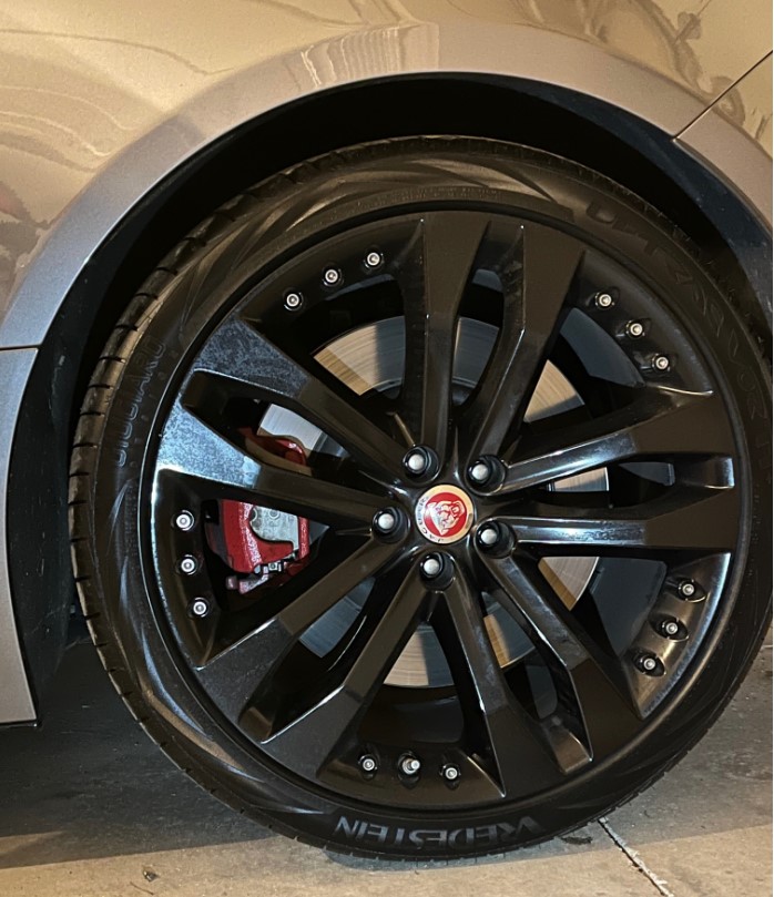

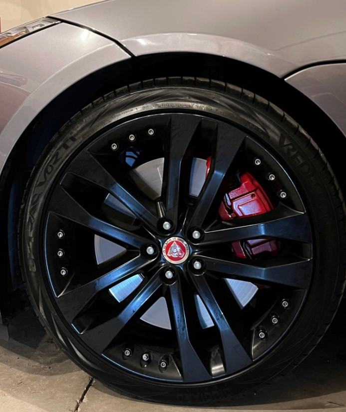

Hi All,
I'm brand new to the forum and this is my first post!
I just made the jump to a 2020 F-Type R V8 AWD Coupe with 20" staggered wheels. I want to put new wheels and tires on it to drive it through the Michigan winter. I'm a few hours into reading forum threads and various articles and have reached an impasse (and could use your advice).
What I'd like to do is:
- Buy a new set of wheels, 9x20 fronts and 10.5x20 rears for a reasonable price ($1,200 or so / set)
- Buy a matching set of Nokian Hakkapelitta R5 tires to go with the wheels
This doesn't seem to be possible since I can't find a good place that offers these wheel sizes and Jaguar bolt patterns (and don't cost full Jaguar OEM prices), and Nokian doesn't make a 295 width tire (but does make a 255). Sigh. Am I missing the location of the secret source of good Jaguar wheel and tire options on the internet?
Now it seems that my best option is to buy four 9x20 wheels (from where I still don't know), four Nokian 255 tires, and add 1-1/2" spacers to the rear wheels. Any better ideas?
I've read about the idea of going down to 19" wheels with taller tires but I'd rather not. I like the look of the 20"s and understand there are potential clearance concerns with the brakes. Speaking of which, how do I know what brakes I have? I'm assuming the Super Performance = 380 mm front and 376 mm rear? I attached a couple of pictures if that helps.
Much appreciated!
Attached Thumbnails Winter Wheels & Tires-front-brakes.jpg   Winter Wheels & Tires-rear-brakes.jpg

I have the same brakes and 19" wheels clear them (at least the Centrifuge wheels do). I would step down in size for winter tires and try to run the narrowest set you can if you will really be driving in snow a lot. I think the extra clearance to the wheel wells would be welcome. Or spend the $3500 it will cost for wheels and tires on a winter beater and keep the F-type in the garage.

Been waiting for the snow before sharing but since you asked, here it is, it’s probably the best winter set up and it doesn’t cost you an arm or a leg!
Perfect stance with spacer
Deep deep real snow grooves, stud ready
Around $200 mounted and balanced.
fronts is a simple bolt on, get some cheap used oem wheels and slap the tires on, spacer optional.
get 2 more front wheels for the rear, add a pair of 50mm bonos spacer(listed as Ford Bronco), this is necessary if you don’t want it looking funny.
Haven’t snowed here yet but served me well in the dry and wet, and I’m confident they are nights and days better than 295 sottozeros i had when it actually snows.

I would second the recommendation to go with smaller sized wheels, you want thinner rubber to cut through the snow.
I opted for Motegi Mar153 19" x 4 and used a rear spacer to bring the rear tires flush (1.25"). Original option for tires were the Hakkapeliitta but I was offered a screaming deal on the P-zeros 3s (245/45/19) and they have served me well.
