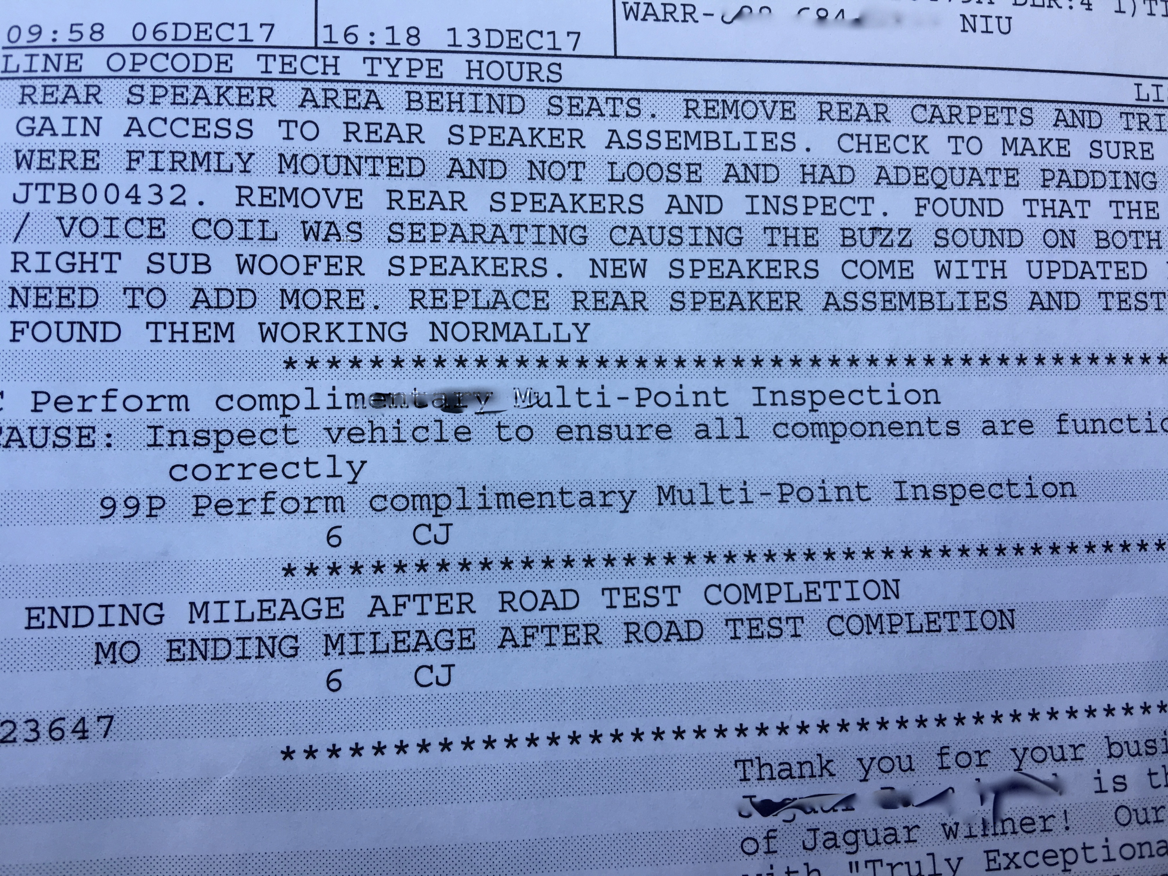

I got my F type back this morning after having a stud replaced and the less than perfect sound system looked at for a buzz. The stud required a new hub and bearing.
They determined the stereo was an issue with the both subwoofers. Both were replaced with a newer version. The current infotainment SW was loaded as well. I was a little concerned about having the seats, carpet and panels pulled. It's fairly involved. I can't tell that the car was touched. Really nice job putting it back together and best of all the stereo sounds so much better. Nice tight bass and a warmer sound. It's still sounds terrible with Sirius as a source but 10x better when I use a better source or even HD Radio.
Attached Thumbnails Wow Jaguar....Stereo all fixed finally!!-fullsizeoutput_1f25.jpeg
