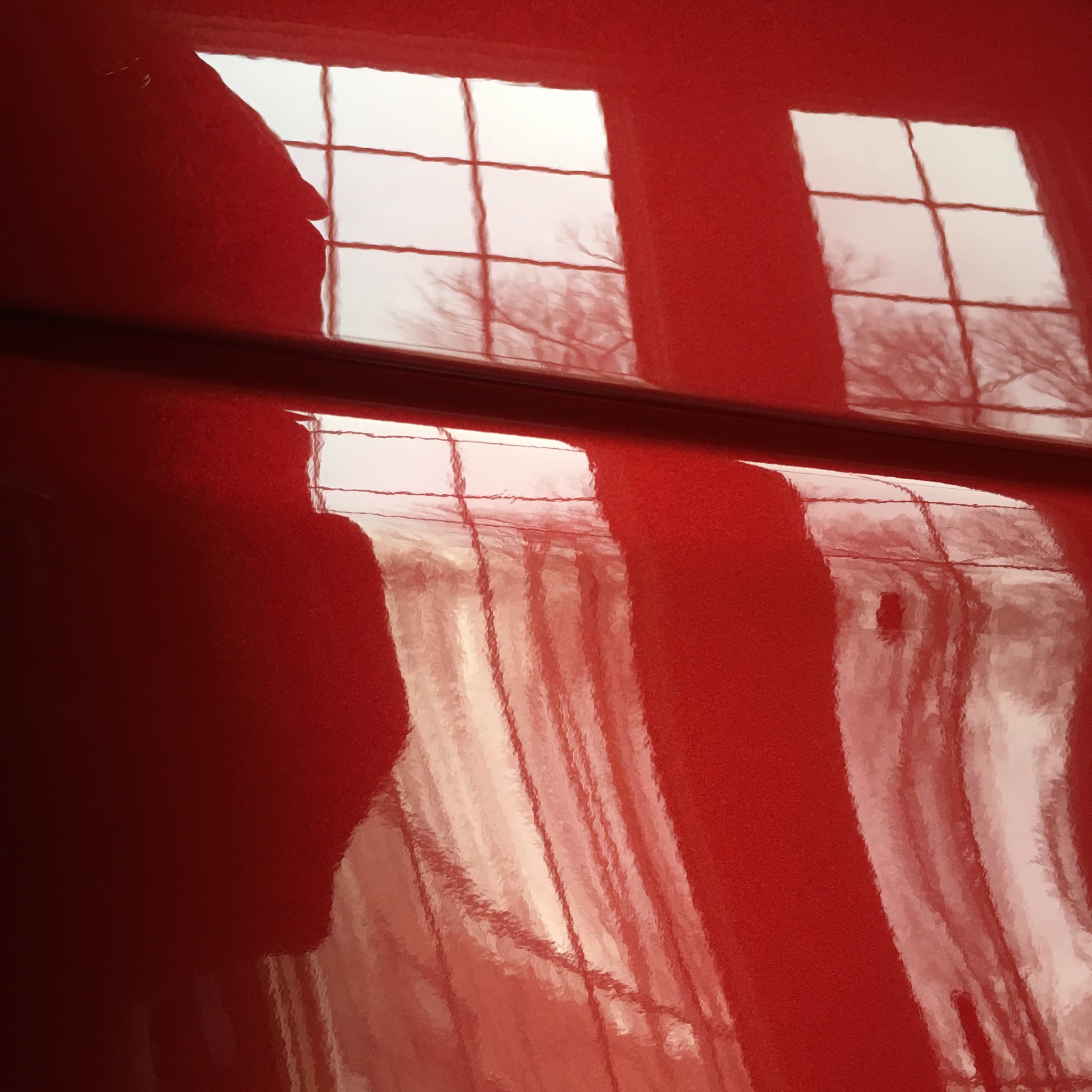

Old May 9, 2016 | 12:10 AM
  #33
myshao's Avatar
Posts: 42
Likes: 7
From: Chicago
Originally Posted by Bret_T
I went by a couple of local shops that apply protection film on high end exotic sports cars. Both offer Xpel and SunTek. They both told me the same thing independently without me asking. They said that SunTek looks better on darker colored cars and is less noticeable than Xpel, but they'll install whichever I want because they both work well. I looked at a couple of Ferraris and couldn't even tell a difference between the panels that were covered and the adjacent panels that were not. But, we were inside. Does anyone here have experience with SunTek?
1. As far as Xpel vs Suntek, I had originally had my V6S coupe wrapped with Xpel Ultimate in the front: bumper, complete hood, A-pillars, rocker panels, rear view mirrors. Within a year, I had a scratch from someone in a parking lot. This made me wrap the rest of the car. I went to a different detailer the second time who does both Xpel and Suntek. Attached is a picture (not my car) comparing Suntek (top panel) and Xpel (bottom panel). Up close the Xpel is a bit grainier and less smooth. From a few feet away, I can't really tell the difference. I did wrap the rest of the car: D pillars, doors, rear benders, rear bumper in Suntek.
2. The hood should be one piece without seams.
3. You should ask for edge wrapping in all places possible to avoid seeing seams/lines.
4. Make sure the detailer does a thorough paint correction removing all swirl marks before the wrap. Otherwise any paint defects are always going to show up.
5. If you add a hydrophobic coating, such as Opticoat, Cquartz, or Modesta, it should go over the clear bra (xpel or suntek). I did Modesta over the Xpel the first time. Second time, I did Cquartz over the Suntek. The water sheeting is great. Cquartz and Modesta really add a nice glossy finish to the whole thing.
Hope this helps.

Well, picked my car today and looks great except for the hood. Detailers first f type and he admittedly struggled with it. There are air bubbles under the film he said will dissapate after a few weeks in the sun. He said he would replace it if I wasn't satisfied, but was not confident of outcome for full hood and suggested a free redo with partial. I didn't really want partial. He said to hold balance of payment (50%) until it smoothes out. Did any of you have issues with full hood? It also does not extend to far corners where it meets A pillars. A small triangle is not covered. Cquart and xpel looks great on rest of car. Not sure what to do other than wait. There is only one other certified xpel installer in my area.
Old May 9, 2016 | 06:13 PM
  #39
Nati's Avatar
Joined: Jun 2015
Posts: 1,400
Likes: 384
From: Cincinnati
Unfortunately inexperienced installers will struggle with this hood. I would call the other shop in your area and ask how many F Types they have done.
Unfortunately if you take the improperly applied film off the hood, he still owes you CQuartz coating on that panel after whoever does the replacement.
The bubbles will disappear over time. It will take about a month. Do not attempt puncture or push on them with your finger. The bubbles are from excess installation fluid and are normal unless really large. This will happen frequently along the bend lines in the hood.
