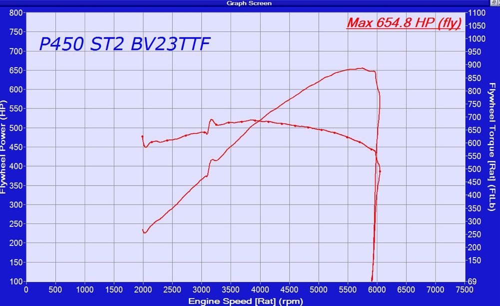

Hi guys
I’m new to both Jaguar and the thread. I recently treated myself to an F type and love it. I went for the 5.0 V8 P450, with the plan to save a few pounds on the 550, and then have it tuned.
I know it has been done to death, however I thought I’d show my recent tune results.
It was done by DMS Automotive who have a couple of places up and down the country. I visited the West Bromwich place for my tune. It as a great team who compared to other tuner companies actually down sold what I was thinking of by telling me that I didn’t need items other companies had recommended.
In all it took about 3 hours for the work which entailed removing the ECU and having that worked on, removing the bonnet, swapping the upper belt and then the runs.
The power is insane. My only issue is still the souls from inside seems very quiet compared to other cars I have owned. I guess that’s down to the closed valves, which I will sort out when I have spare cash again.
The result is an outstanding 654hp with an almost continuous line of power all the way to the end.

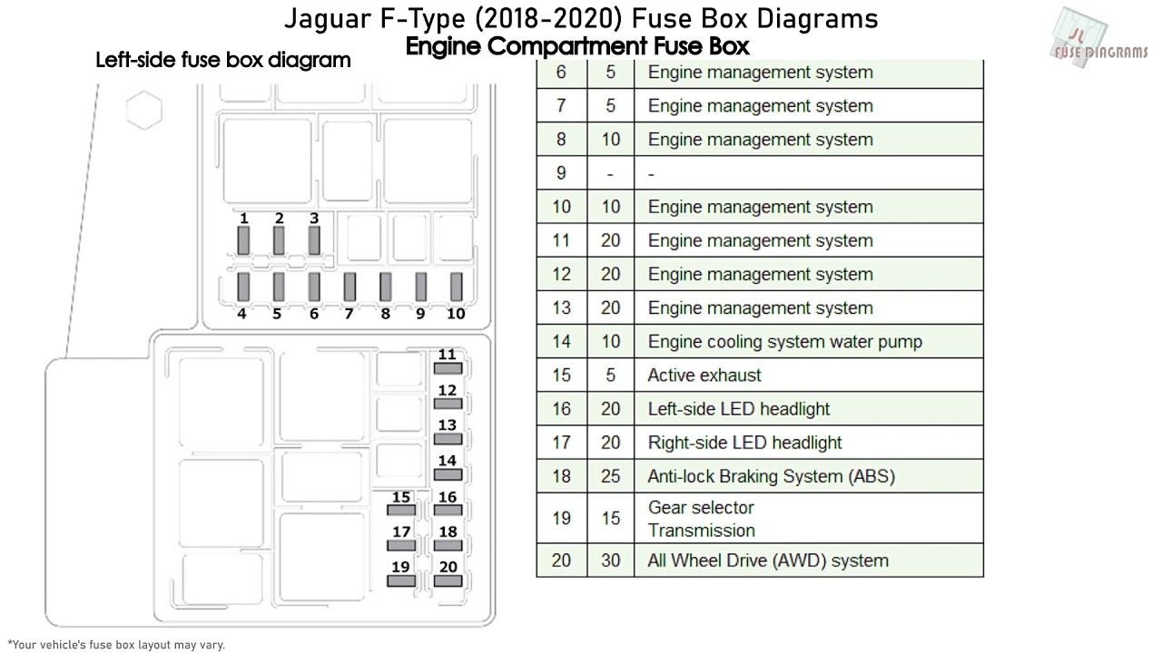

Old Dec 17, 2023 | 02:04 PM
Fatcat81's Avatar
Joined: Dec 2023
Posts: 7
From: Shropshire U.K.
Originally Posted by Thunder Dump
A quick and dirty way to make it louder right now at no cost: make sure the valves are open when the car is off, pull fuse 15 under the bonnet. This opens the valves permanently (disables the active exhaust switch). You'll get much more noise and volume below 3000 RPM.
Hi Matt
i removed the fuse earlier today. When I went to drive it later on I had a parking brake fault and gearbox fault. The car wouldn’t even start. I’ve put the fuse back in and all is fine again.
I guess the new cars know if the fuse is out.

Is it still fuse 15 in the new cars? is there anything else listed for that fuse in the handbook?

Still listed as 'Active Exhaust' for MY24 cars on the digital handbook on Jag's website
I suppose there is the possiblity that its function has changed in the last couple of years in response to the continuing war against noise. I'm sure I'd read either on here or the UK forum that it works OK on MY21 cars at least, so if it has changed then it's a very recent thing.

Are you sure you had #15 out? Should be the inboard-most of the three that are in a line by themselves in the second row. This is the same layout as the 21+ cars:
If you pulled out #19 by accident (wrong end of the row), that's the gearbox fuse and would explain why you had that error and it wouldn't start. It's a 5A tan/brown fuse (the only 5A fuse on that side of the block) and shouldn't affect anything else at all since the circuit is *only* for the active exhaust. Mine is a MY23 and my previous was a MY18 and it's the same fuse. MY24 is also #15.

Thats a wierd looking dyno sheet, drops off at 6k when the car redlines at 6.5-6.8k.
Also all dyno plots should cross at roughly 5250!!!

look at the scales, the graph is scaled differently for hp and torque. I imagine they just let off, probably watching the torque curve steadily drop off.
