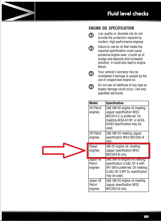

Hi gents
I would like to change engine oil for my jag. And i need your help which engine oil fit my car?
Type?
Grade?
Country temp 45 degree to 50.
Please help to find out the best engine oil..
Thanks

Is the recommended oil not listed in your Owners Handbook and other documents ? Is the car petrol or diesel ?
It is diesel..

Originally Posted by Maaden
I would like to change engine oil for my jag. And i need your help which engine oil fit my car?.......
This is probably the most discussed topic on the Forum and one on which everyone has an opinion.
Here's what the Owner's Handbook has to say on the subject (see section boxed in red):
The important thing is to select an oil meeting specification WSS M2C934-B. This will be on the container. The brand is of secondary importance and restricted by what is available to you locally.
