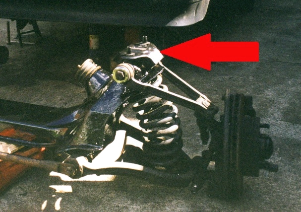

With the replacements you've already done on the front end I'd next check the metalastik Crossmember Vee Mounts aren't split allowing the body to 'float' on the suspension.
When these separate it often causes vibration.

Hello Graham. My 93 xjs convertible front end doesn't look like the pic you attached. Thanks anyway. Any other possibilities? The vibration always occurs between 65-70 mph. Rotating the tires doesn't help, nor does balancing.
