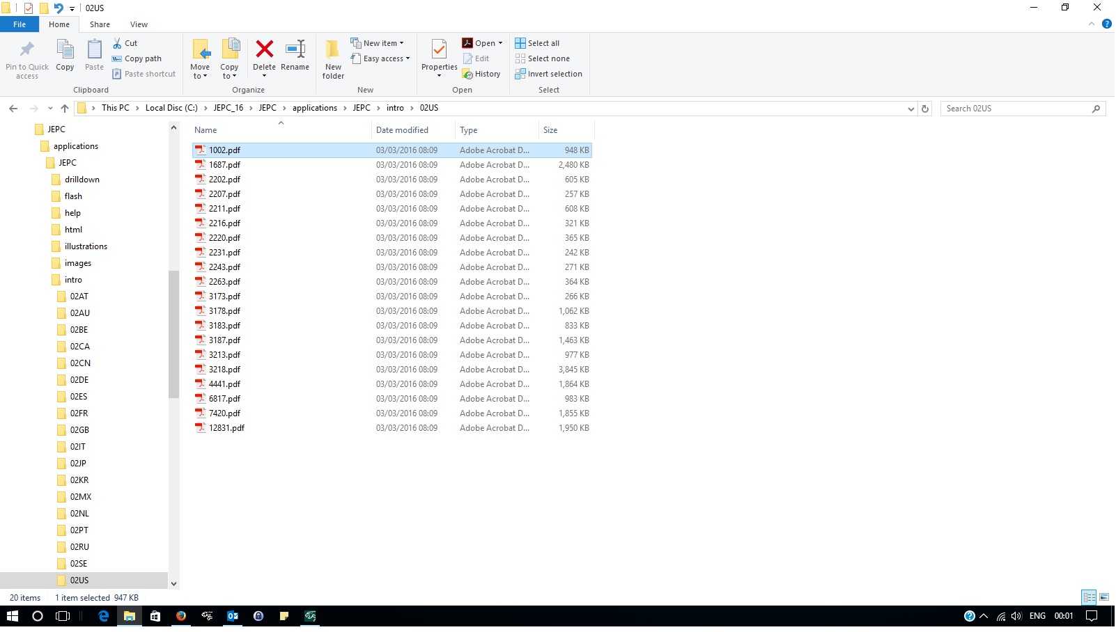

Bob,
Right click doesn't work any more but the information is still there. Drill down to the Intro folder to find it in PDF's.
I have JEPC installed on my C:\> drive in folder JEPC_16 so the path for me is:
C:\JEPC_16\JEPC\applications\JEPC\intro\02GB
You'll want the \02US subfolder.
