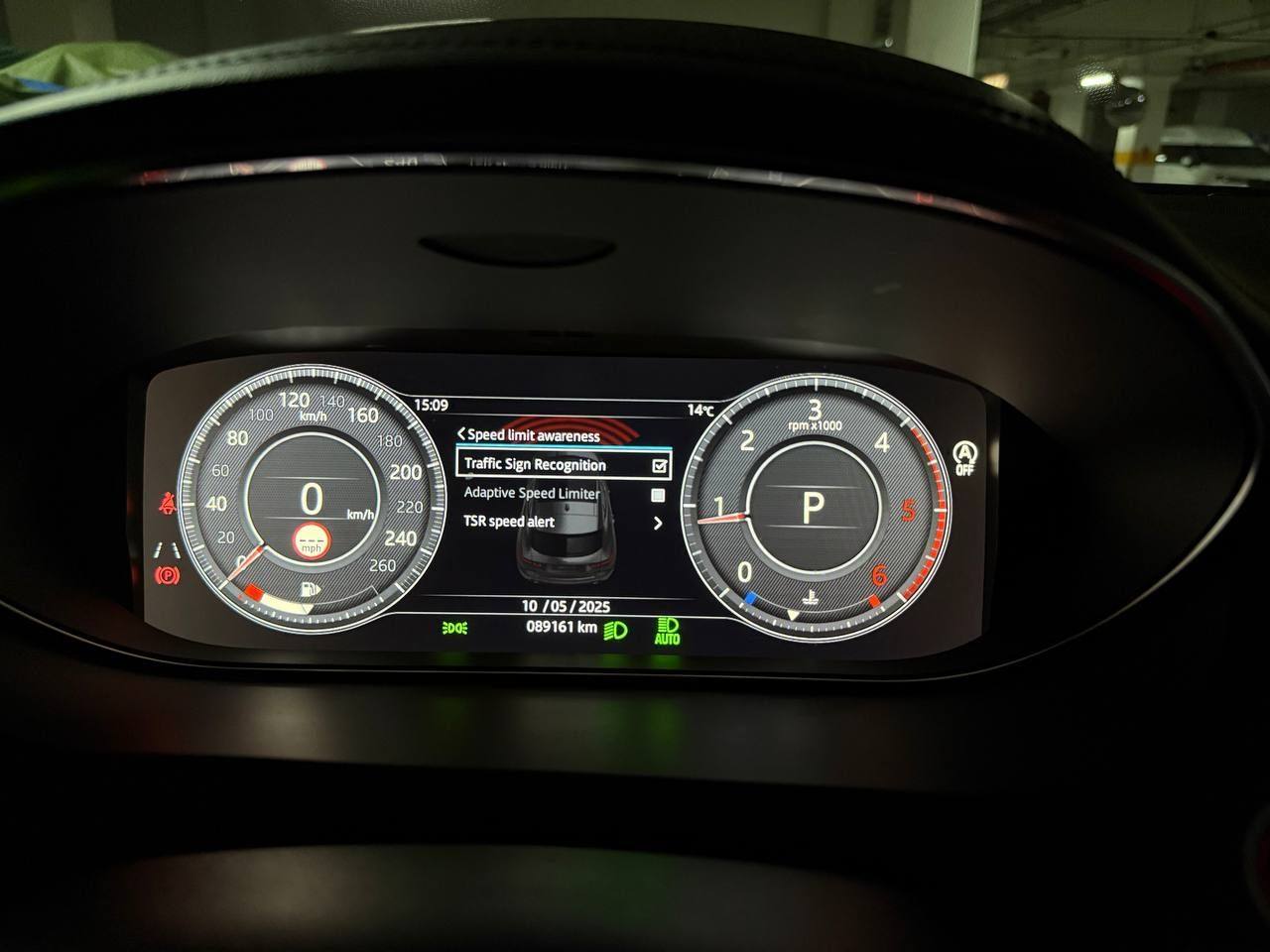

Hi guys,
My 2nd Jag is 2019MY E-PACE. It is equipped with ACC(Adaptive Cruise Control) and LKA(Lane Keep Assist). I’m trying to activate TSR(Traffic Sign Recognition). I have modified the CCF.
  • EUCD098 0x53 LDW Fitted Enable Menu and .. & TSR Fitted with Overspeed
  • MultiCAN742 0x03 TSR Fitted with OverSpeed
Then I executed “PathFinder > IPMA > Learn CCF...”. TSR appears on the instrument cluster, but it disappears after a few minutes. Also, I’m unable to check tick TSR. I have updated the IPMA to J9C3-19H406-BH. Other E-PACE that support TSR have the same part number and software version. What could I be missing?
Thanks!
