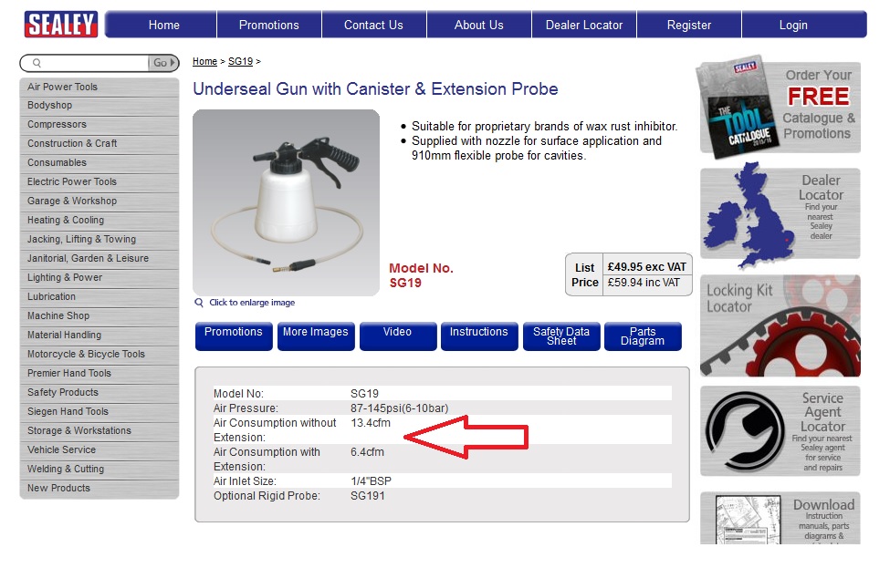

There is no substitute for capacity!
The Sealey website gives the pressure and consumption for their SG19:
You could be struggling with the 24 litre.

Thank you Triple G. That sways it. I shouldn't need to give long blasts with the gun. Just short blasts. Anyway, 50 litres it is. I'll report back in a week or two and let you know how I get on.
