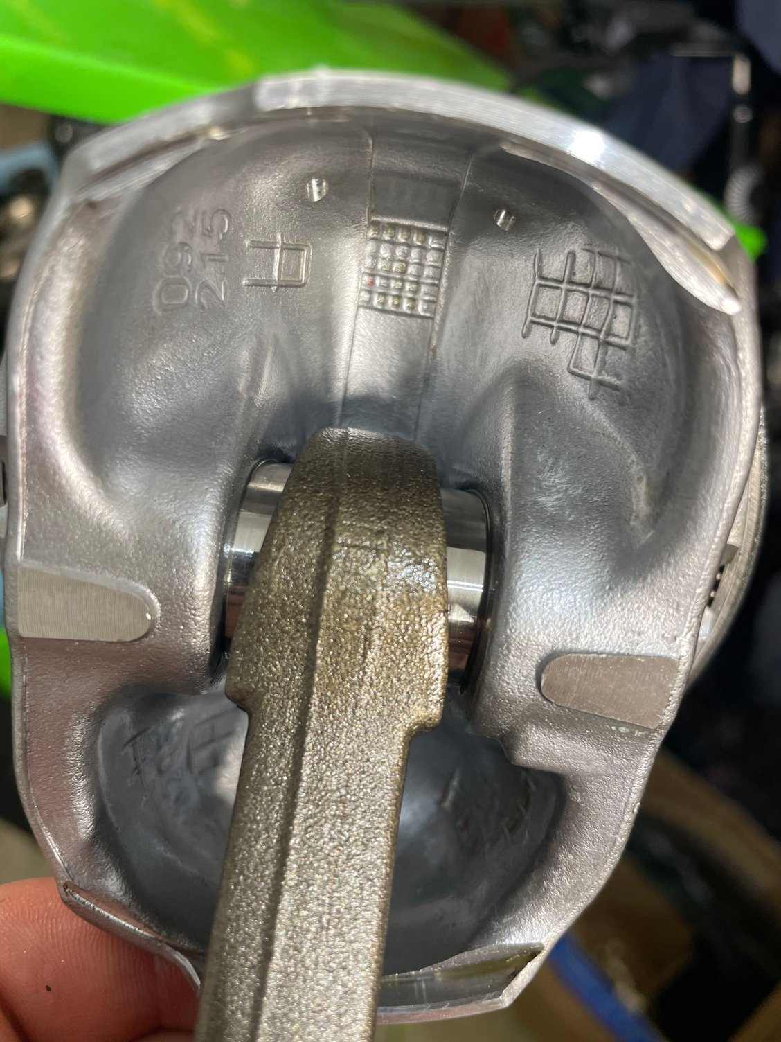

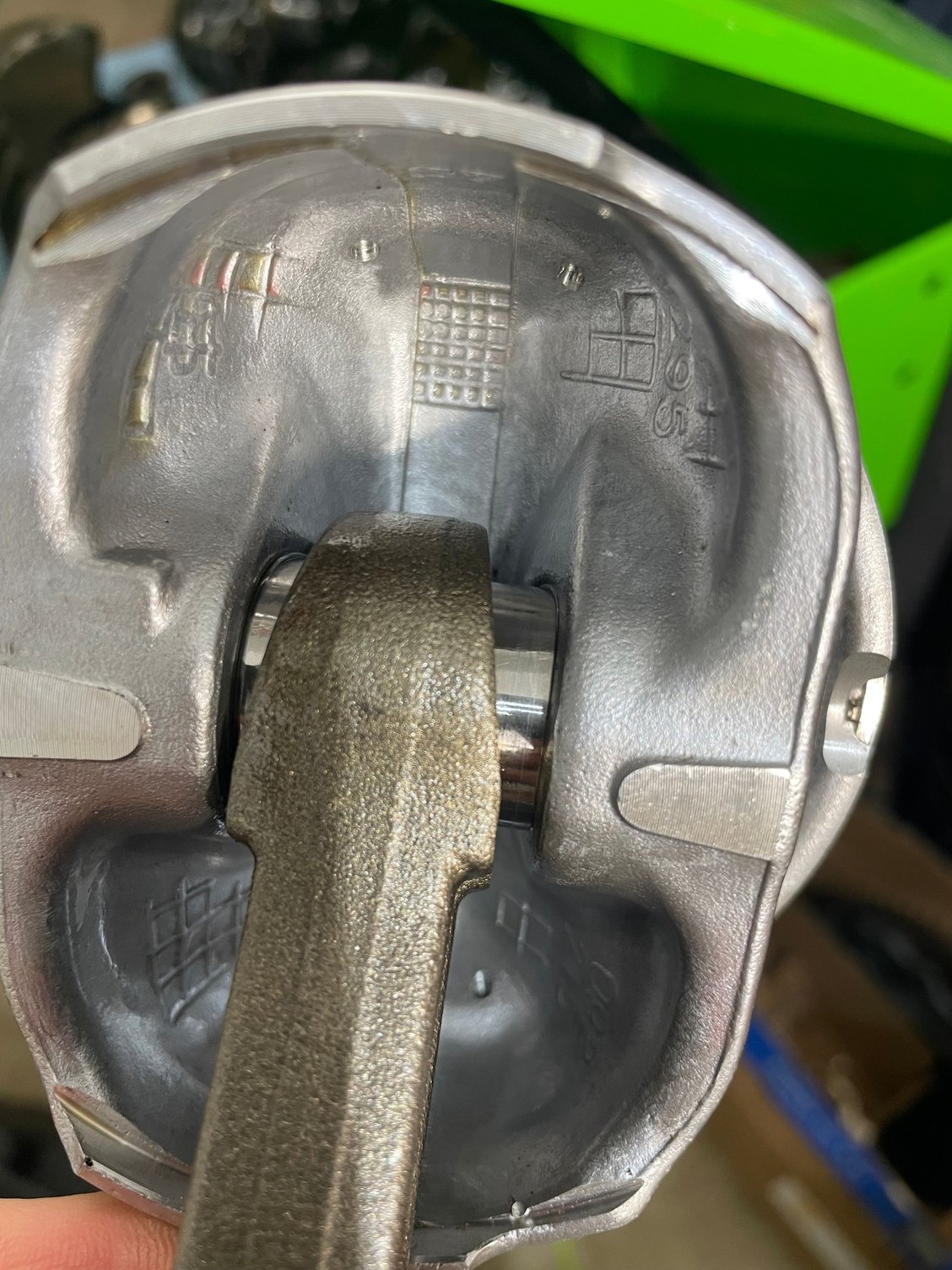

Bought new pistons from ebay (approx $200 USD delivered). Generally look fine but the skirt isn't quite right. It's like the skirt is shaped for the NA version (no oil squirters above the crank/ between the bores), but the top faces is shaped for the SC. SC pistons have that little notch presumably to not block the oil stream at the very limit of travel. Parts/boxes are not marked in a way that lets me say yep, these are for the ___ motor, thus not for mine. Bonus - they don't match the ebay pic.
Anyone else seen these? Are these perhaps a newer revision?
subsequent pix show the oil squirter vs piston skirt. hard to show more clearly but it looks like the skirt will just barely miss the metal squirter, but certainly block the flow.

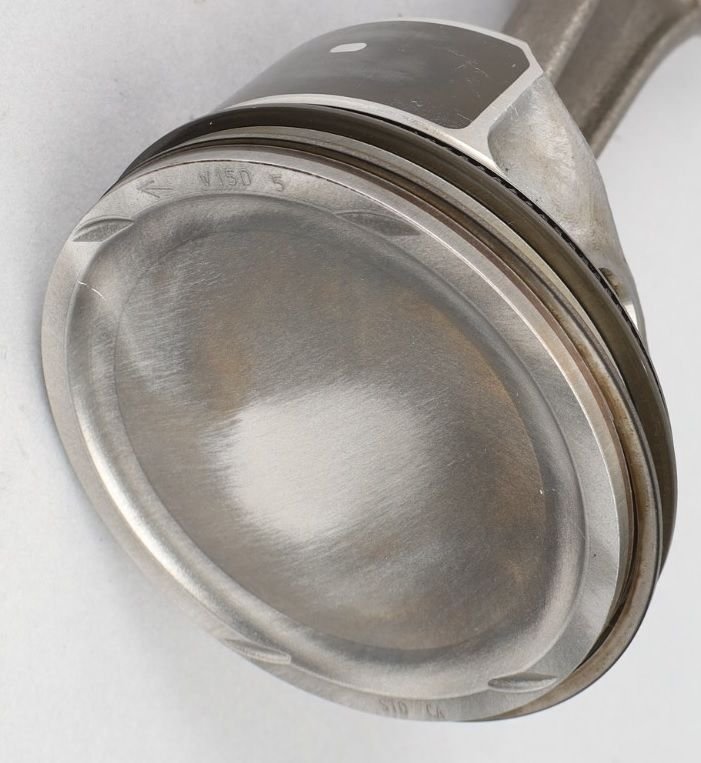

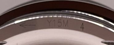

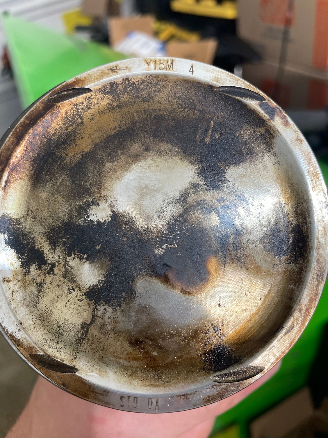

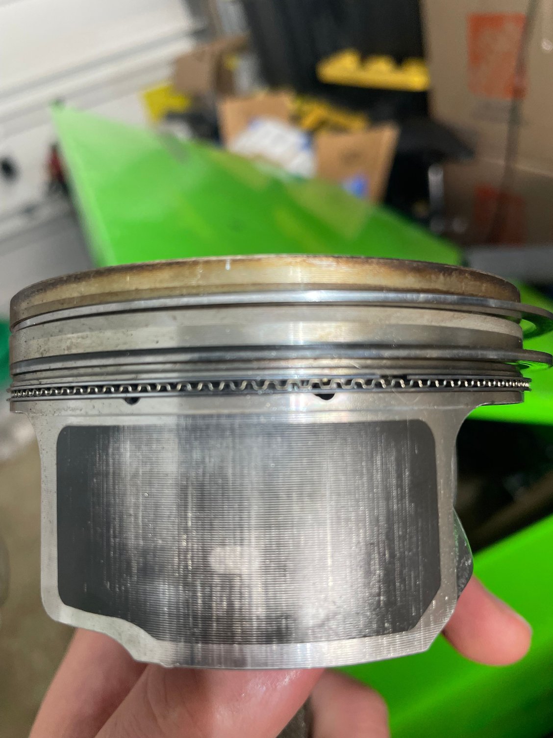

Have kind of similar question.
I’ve been working on a project 2015 Land Rover Range Rover autobiography with unknown history. All I know it is not original engine.
trying to figure out if the pistons are oem.. They look suspiciously clean.

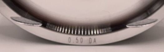

From looking at pistons I see OEM and after market with those markings. So it's not clear.
Here is a new one from Euro-Amp and it looks to be marked the same as yours. Difficult to see in that picture. They have the notch.
Euro-Amp Piston
Here is another new piston from EBay and the markings are the same as yours. This is an aftermarket part.
But here is an OEM used piston and it has the same markings. But no notch on the piston skirt.
Used Piston
Hard to see but the same markings. Note this is listed as a LR piston.
I was surprised to see how many internal parts are now available. I had not looked in some time but many piston/rod sets in std. and oversize.
Euro-Amp Piston
Used Piston

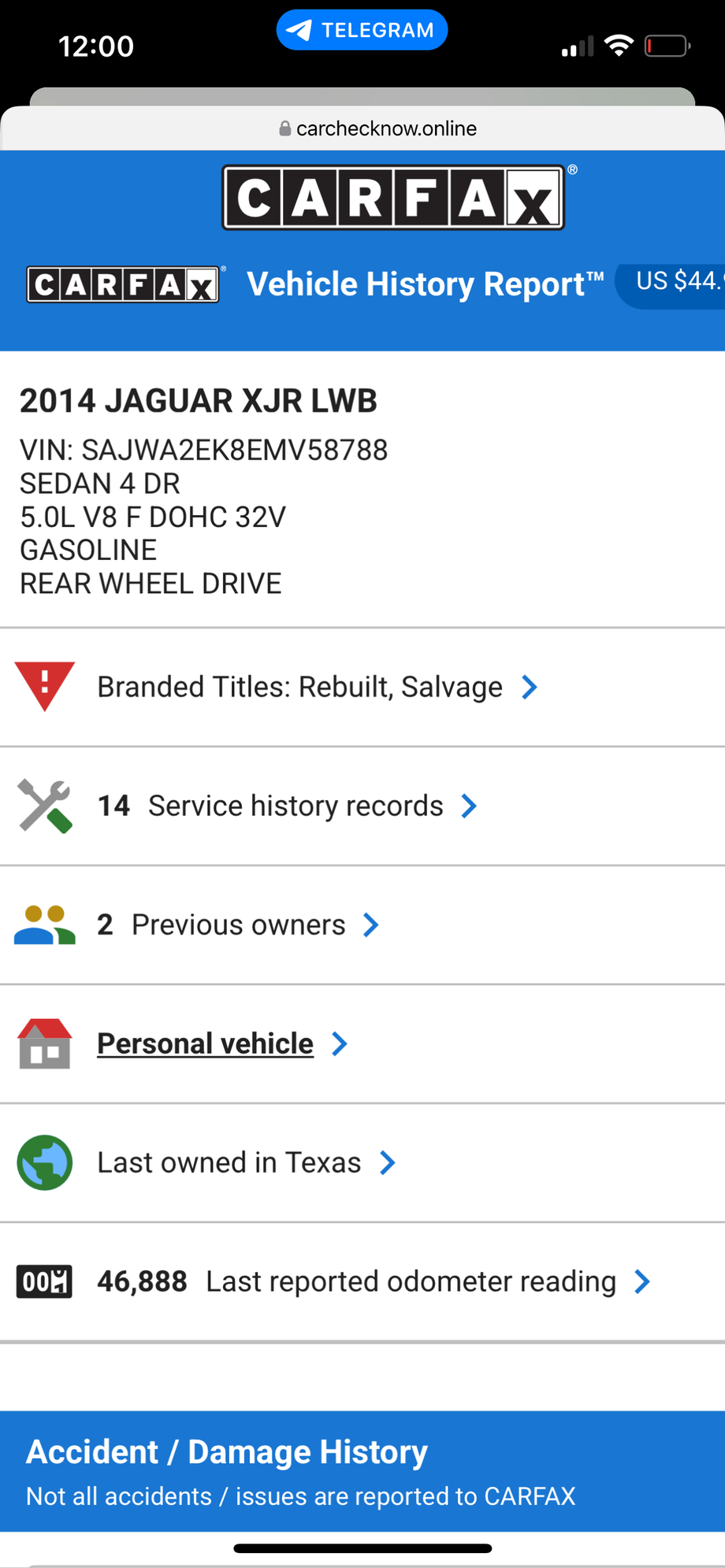

just bought a 46k miles engine on eBay from EUROPART for around 5k. Sounds too good to be true, but the seller seems to be ok.
