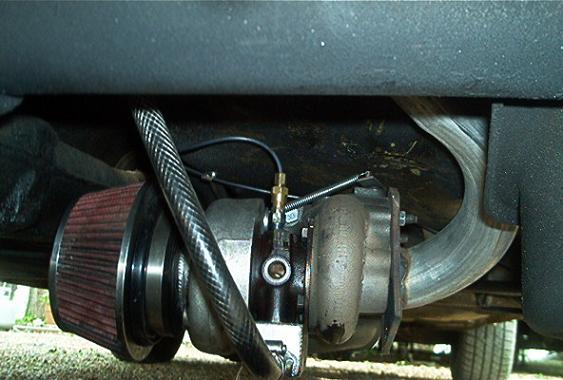

Old Mar 23, 2012 | 10:11 AM
ronbros's Avatar
Joined: Jul 2010
Posts: 7,362
Likes: 1,241
Default pix, remote turbo.
you must have a lot of Jag engines laying around, like 4.2 cranks, pistons, rods and stuff!
like brutal said!!
you dont need headers, for a remote mount turbo system, just run the complete exhaust flow into a rear mounted turb. no cats or mufflers,(turbo acts as a muffler).
then pipe the cold air from turb. upfront to throttle body. no I/C.
use a water/alcohol sytem for detonation control. reflash ECU.
use E85 fuel,,and easy 400+hp.
you dont even have to take the engine out!

Yeah I like that turbo idea, instead of a collector where I combine the 2 banks I'd put the turbo. The only problem I see is getting the turbo to the intake inlet from there. I don't have much engine compartment room
