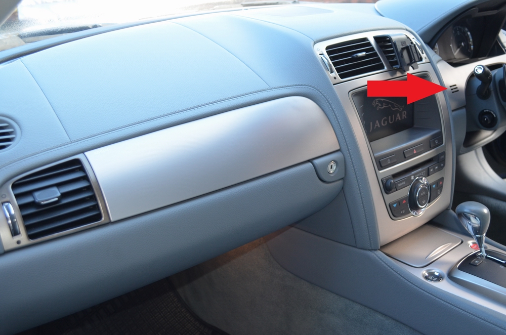

If your Aircon isn't maintaining the right temperature, it could be that the 'in-car aspirator' is in need of a clean.
Fitted behind a grille in the dash, the in-car aspirator helps maintain the set temperature and, in later models, the humidity, in the cabin.
XK/XKR (2006 onwards)
A/C not maintaining temperature?-aspirator-xk.jpg
XK8/XKR (1996-2006)
A/C not maintaining temperature?-aspirator-xk8.jpg
X300/X308 (1995-2003)
A/C not maintaining temperature?-aspirator-x300.jpg

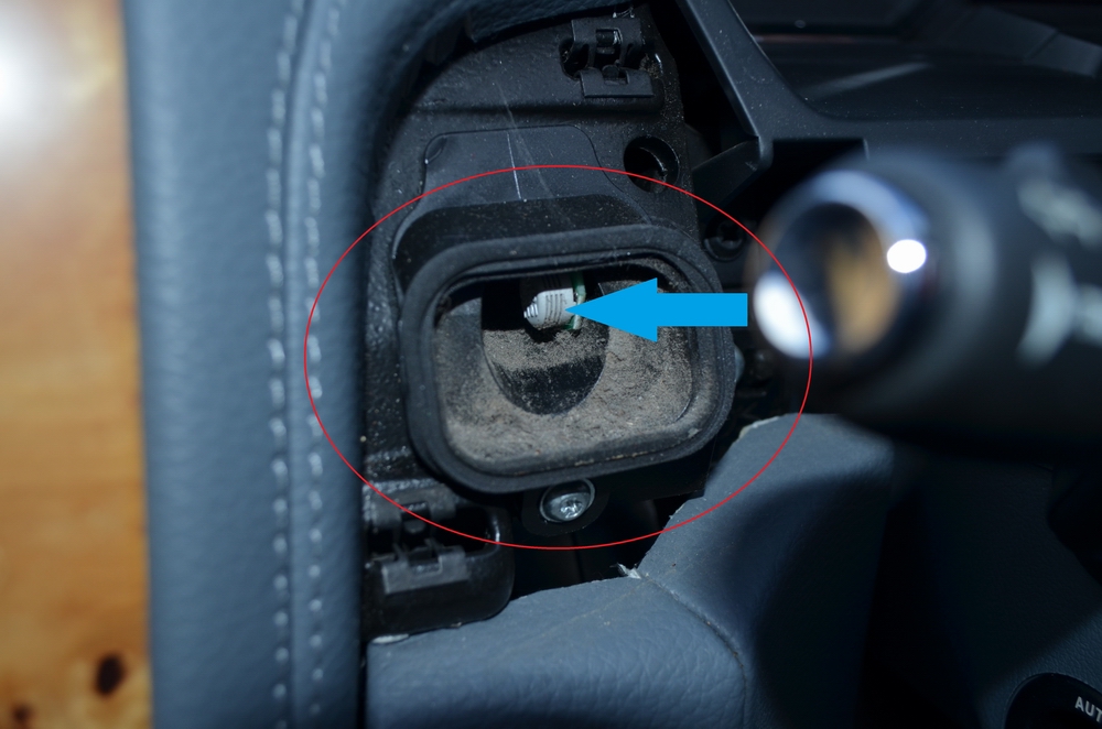

My XK wasn't pushing out heat unless I set it to MAX and then it was way too hot.
Removing the dash panel, this is what I found:
A/C not maintaining temperature?-aspirator-xk_2.jpg
The inlet (circled in red) was full of dust and, more importantly, the thermistor (arrowed in blue) was also blocked. (X300 and X308 also have a small electric fan behind the inlet)

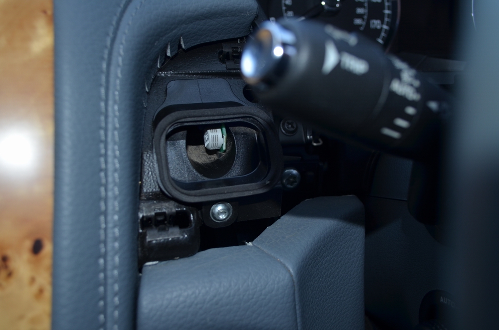

Cleaned out with a vacuum and can of compressed air.......
A/C not maintaining temperature?-aspirator-cleaned.jpg
....... the A/C can now be set to a comfortable and constant temperature again.

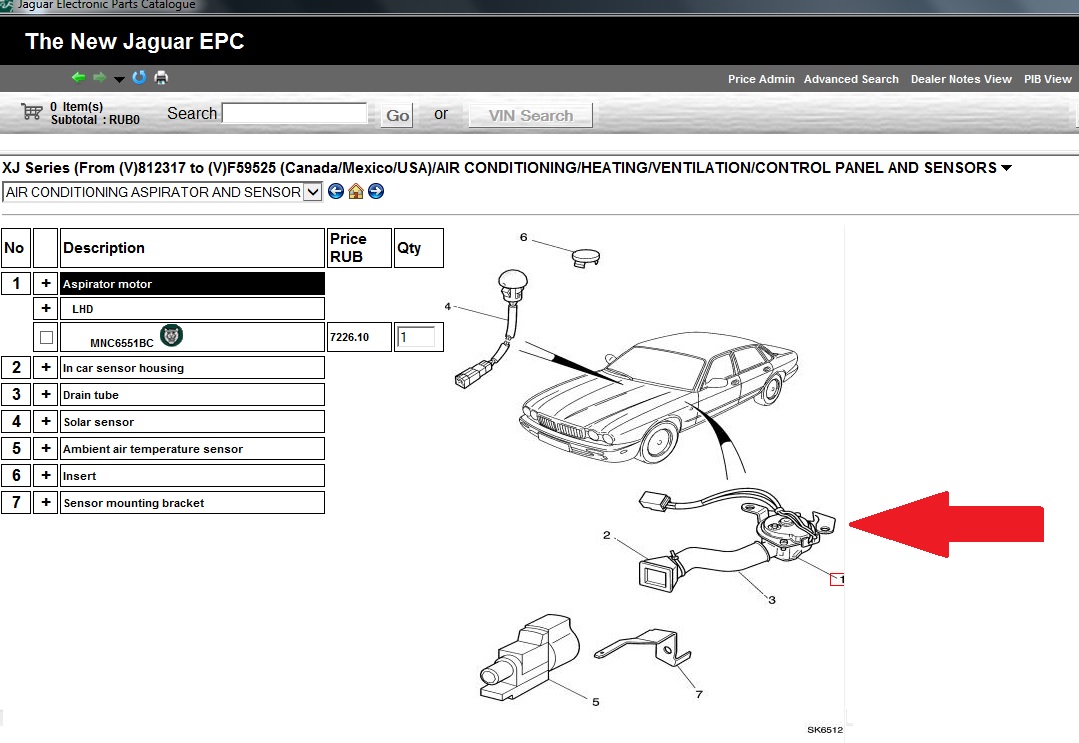

The same principle but there's a miniature fan in the X308 Aspirator Motor assembly.
A/C not maintaining temperature?-aspirator.jpg
Collects dust the same way too!

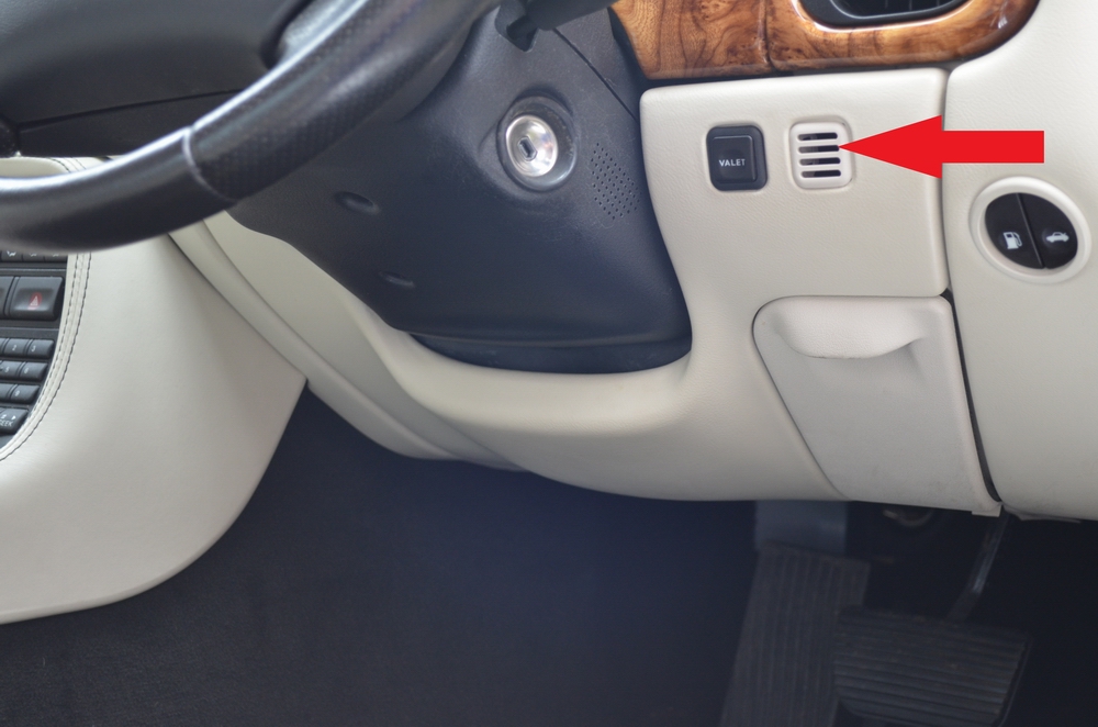

How do I go about servicing it? Is it behind the little Vent on the left lower dash?
Also, I am jealous about the meet in Brighton. I spent much of my youth in Luton Beds
Wish I could attend
Old May 23, 2014 | 09:47 AM
Originally Posted by here I go again
.... How do I go about servicing it? Is it behind the little Vent on the left lower dash? .....
YES - the Knee Bolster (lower dash trim panel) has to be removed to access it. Don't try prying the Vent out from the front or it will break.
Two screws secure the bottom edge of the Bolster (see red arrows). Once these are removed it can be pulled straight towards you to release the two top clips (see one arrowed in blue). This is my RHD 2005 XK8 but it's the same procedure for your X308:
A/C not maintaining temperature?-bolster.jpg
Disconnect the harness connections the the Aspirator and the Bolster can be removed from the car. The Aspirator can be unscrewed from the Bolster for a thorough cleaning the follow Doug's advice in post 2 to oil the fan.
