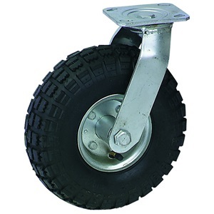

For short term, semi-disposable use, how 'bout some cheapo casters screwed directly to the chassis. Like so:
That's a $16 Harbor Freight special as an example. Only rated for 600 lbs. but should do the job (unless you're gonna lie down under the chassis!)
Swiveling, non-swiveling, different type wheels/tires for various surfaces. Lots of options.
I bought some 10" pneumatics to build a rotisserie someday, hoping they will work in my application. I will have to occasionally get off paved surfaces with it. They were $15 at HF.
Good luck,
Retro
