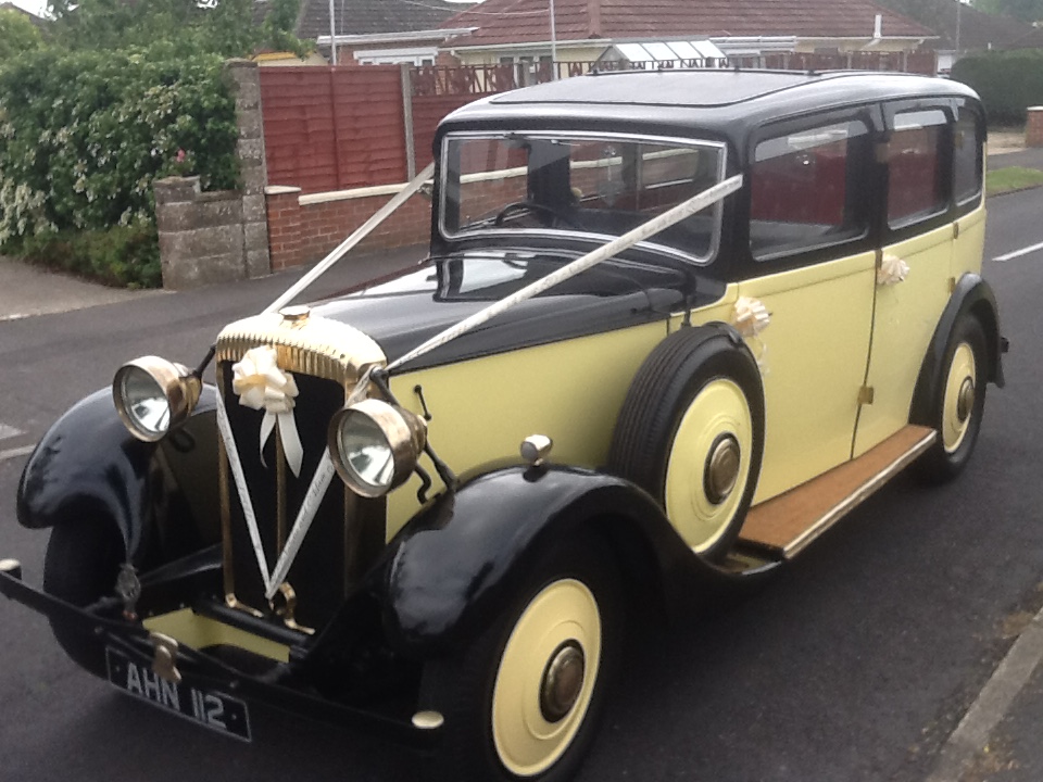

Many months and gallons of coffee have passed since I last posted, at which time I met up with Jim Forrest (see previous posts) who has been a great inspiration and sounding board for me during restoration of my 1934 Daimler project. Sadly young Jim passed away last Autumn and his passing has left a big hole, he was a truly great engineer and innovator and I would like to dedicate the success of the Daimler to him. For those who were supporting and assisting my initial requests for tech information may recall, I started on a very ambitious resto, my first Vintage project, zero data and a car (basket case) that had stood in a garage/barn for about 40 years. My aim was to drive my granddaughter to her wedding in the car which with the greatest of thanks to all, and especially Jim, I managed to achieve, with only 2 weeks to spare. I am thankful that Jim managed to see the car running but alas was too unwell to see her finally dressed for the wedding. Jim did take some video which he posted on YouTube under Daimler LQ and Lq3-20 showing initial runs, I have tried, and failed to add more than one picture of the finished car (well almost) to this post but as normal the technology has beaten me, perhaps someone could advise me how to do it. Thanks again for your support and hope you join with me to remember Jim. Cheers
Den.
GGG (03-07-2017)
