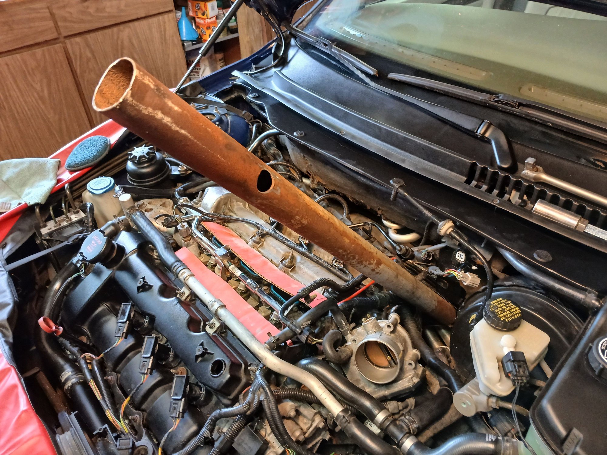

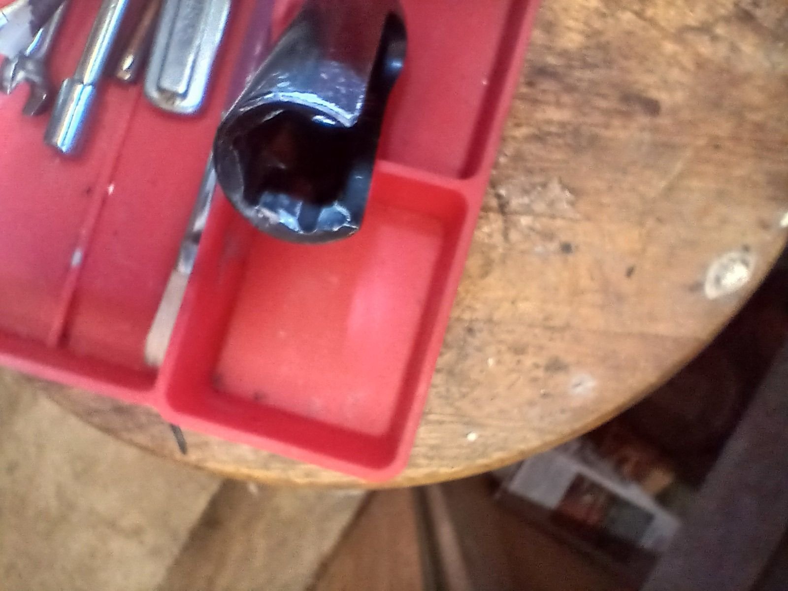

I've had a code for A bank upstream O2 sensor for awhile and had already ordered and received a replacement from Rock Auto that was sitting on the bench. I was getting my Winter car (95 X Type VDP) ready for Fall, replacing plugs and coils and realized that this was the time to finally put in that bank A sensor while I had the intake manifold off, so, I ordered another sensor for B bank for 1/3 off closeout price (Denso) along with two sensor sockets (Performance Tools) and set about. That's when the gremlins showed up. The A bank sensor would not budge with a half inch drive breaker bar, and upon inspection, I found the two sensor sockets had failed.
They were not a tight fit and the interior shoulders had been cut off. So, I looked for another tool. A box end/ring spanner would not go over the wire connector, so in frustation, I took my most robust 22m open end wrench
No brand, just
No brand, just, "China". and put a long pipe on it .
Spoiler

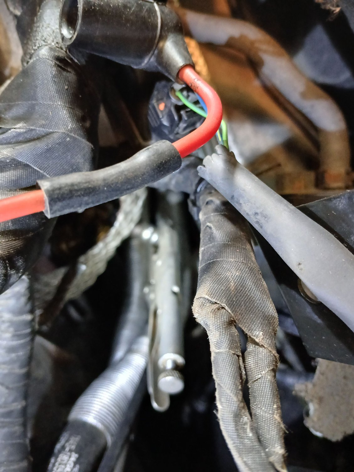

The exhaust to cat stud interfered with the open end wrench, but the wrench held, and I was able to remove the sensor with one mm rotations of the wrench. It was still too rusted to turn off by hand, so I used a long nosed vise grip to turn it off.
Here's what the problem was: no anti seize, just rust.

If replacing the O2 sensor I don't fight it!
Cut the wires off the sensor and then use a 6 point socket on the sensor.
Also the O2 sensors need little torque when installing so a nice snug is all that's needed.
I also use anti-Seize on the threads too (Old habits are hard to break!) but if you read the sensors already come with a coating on the threads.

Denso sent them untreated, but with a small packet of anti seize. I was about to cut the wires, but thought I should test it for a spare, since they cost so much. I also considered cutting a slot in an old 7/8 spark plug socket with an angle grinder. Not many 7/8 plugs in my life anymore. In any case, the PT sockets are going back–pretty soft steel for tough work.
