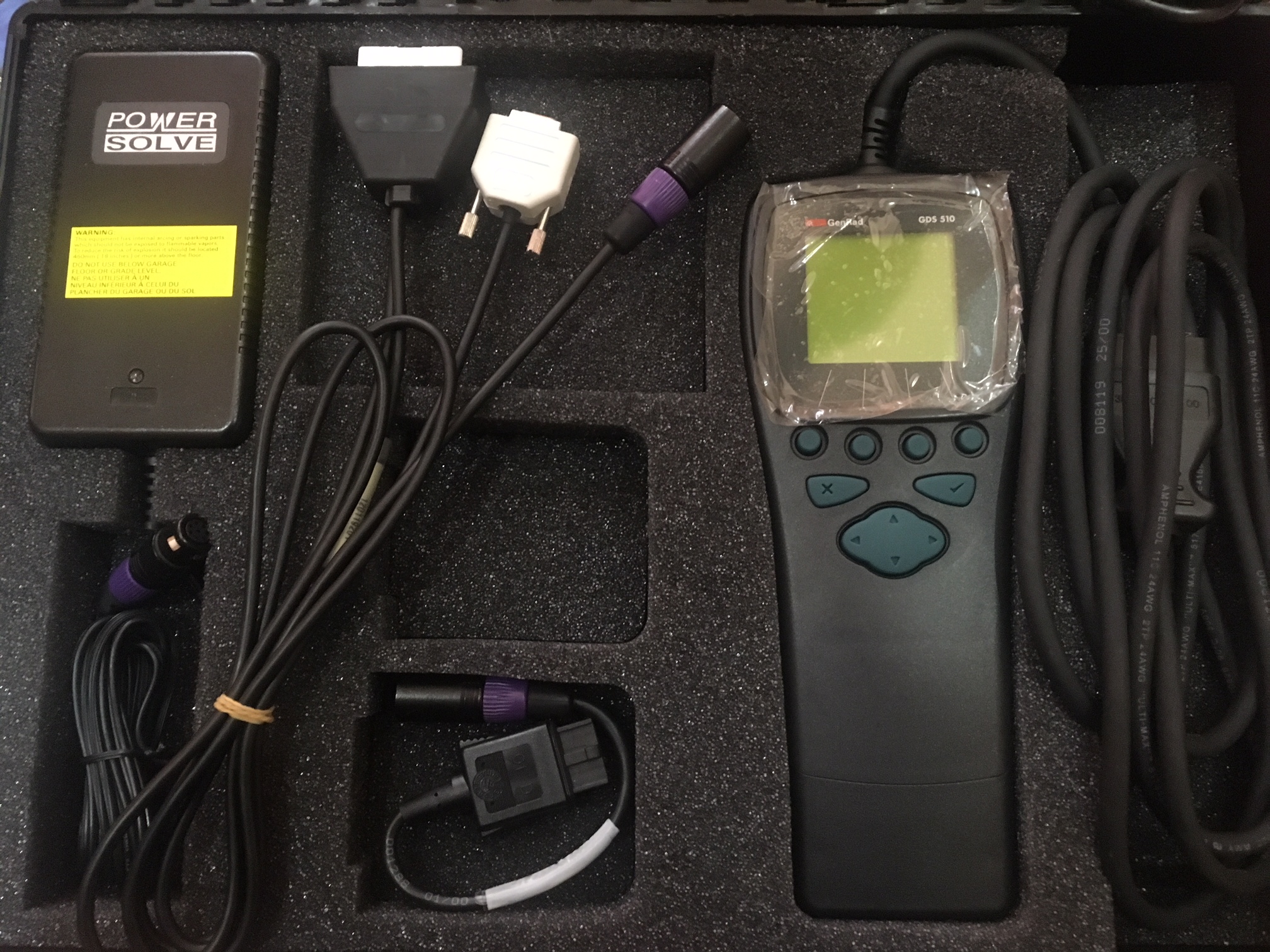

I picked up a GDS 510 scanner recently, brand new, never used.
It did not come with an instruction manual, and there seems to be very little info out there on these tools.

Here are the pics of what I got.
Genrad GDS 500E / GDS 510 scan tool info-img_8423.jpg
GDS scanner, in a case, with a power supply, and some extra cables.

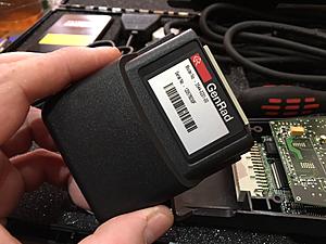

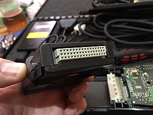

This is the "replaceable PROM cartridge" that they talk about in the bulletin. The connector on the bottom does not match up with the cables that came in the box, I can only assume that connector was used by Genrad for updating the PROM itself. Or there might have been another cable that the user could have used for updating, maybe, I don't know.

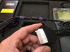

Genrad GDS 500E / GDS 510 scan tool info-img_8430.jpg

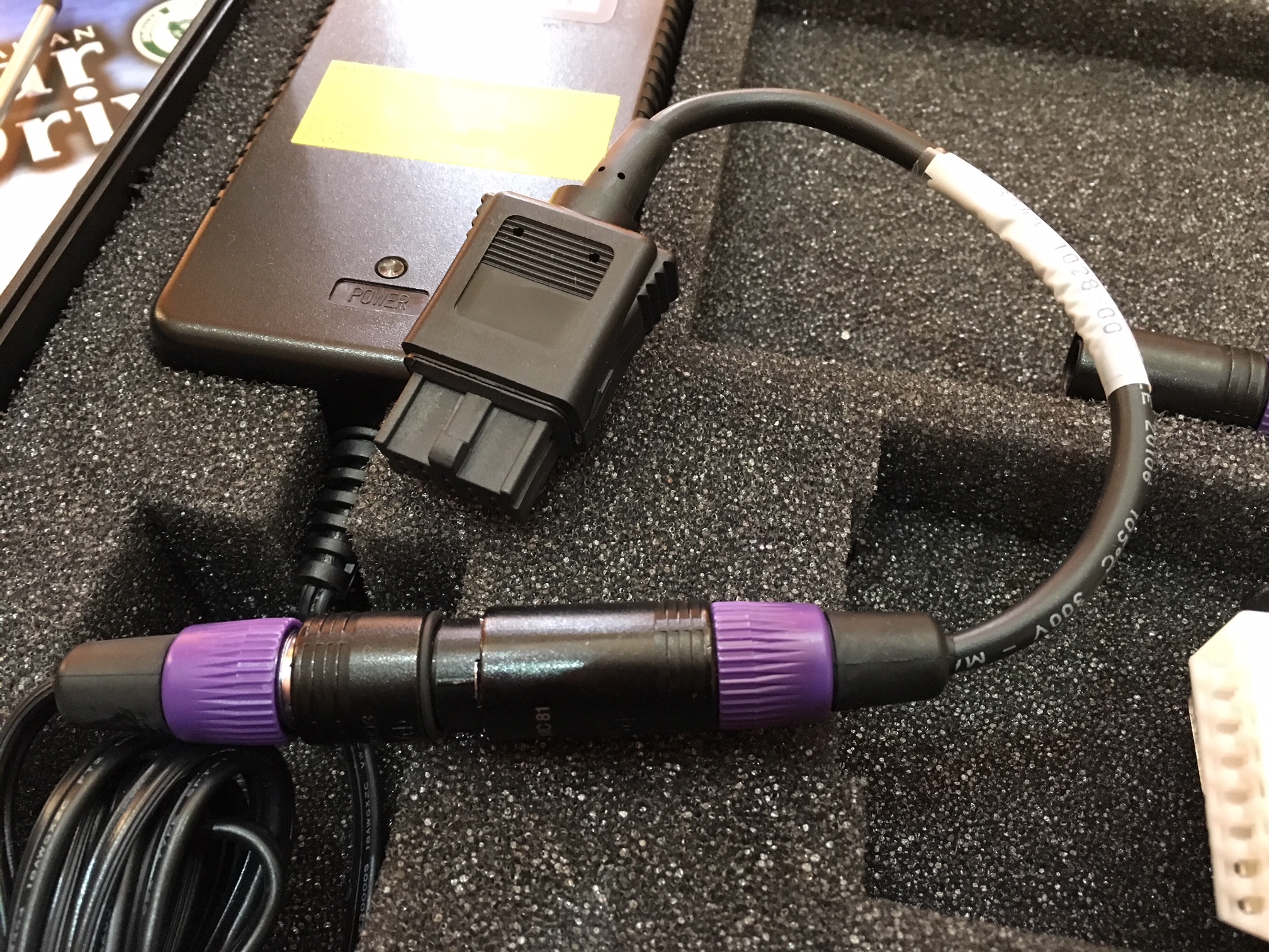

This cable allows you to power the unit from the power supply, via the DLC cable. No idea what the serial connector on the cable is for. A printer maybe?
Genrad GDS 500E / GDS 510 scan tool info-img_8431.jpg
This cable has me baffled, the plug connects to the power supply, and the other side is the same as the power cable for the GDS3500 / WDS, and the VMM. It's an add-on that let's you charge your WDS?
So I guess my questions are;
1. does anyone have a user manual for this thing?
2. does anyone know about updating the PROM to the latest version?
Maybe I already have the latest version, I've got no idea... there are no dates on the unit that I could find.

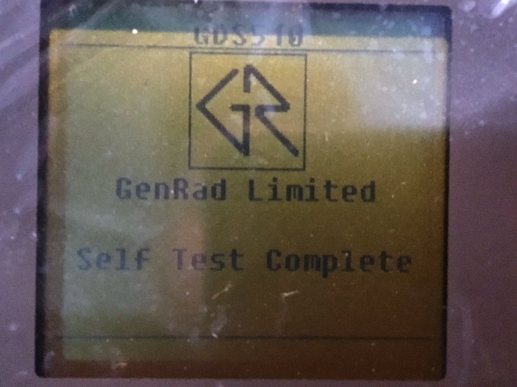

Genrad GDS 500E / GDS 510 scan tool info-img_8432.jpg
Genrad GDS 500E / GDS 510 scan tool info-img_8438.jpg
Genrad GDS 500E / GDS 510 scan tool info-img_8444.jpg
Genrad GDS 500E / GDS 510 scan tool info-img_8445.jpg
Genrad GDS 500E / GDS 510 scan tool info-img_8446.jpg
Genrad GDS 500E / GDS 510 scan tool info-img_8449.jpg
Genrad GDS 500E / GDS 510 scan tool info-img_8451.jpg
Genrad GDS 500E / GDS 510 scan tool info-img_8452.jpg
Genrad GDS 500E / GDS 510 scan tool info-img_8454.jpg
Genrad GDS 500E / GDS 510 scan tool info-img_8455.jpg
Genrad GDS 500E / GDS 510 scan tool info-img_8456.jpg
Genrad GDS 500E / GDS 510 scan tool info-img_8457.jpg

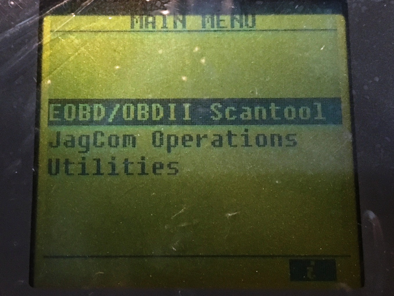

I connected it up to an XJR6, under the Jagcom menu was only transmission and ABS, talking to the engine ECU was only possible through the OBD2 menu, nothing really in there apart from reading/clearing codes and freeze frame, no service or calibration functions.

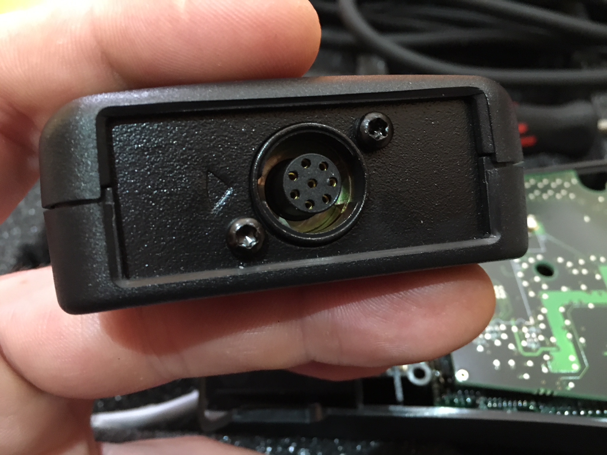

When you look at the picture of the instructions, you can see a Current Clamp in the picture, which connects to the socket on the bottom of the GDS510.
Also looks like there is another cable or device which plugs in that socket as well. No idea what that does... I guess they got a little ahead of themselves planning for features and applications that never materialised?
