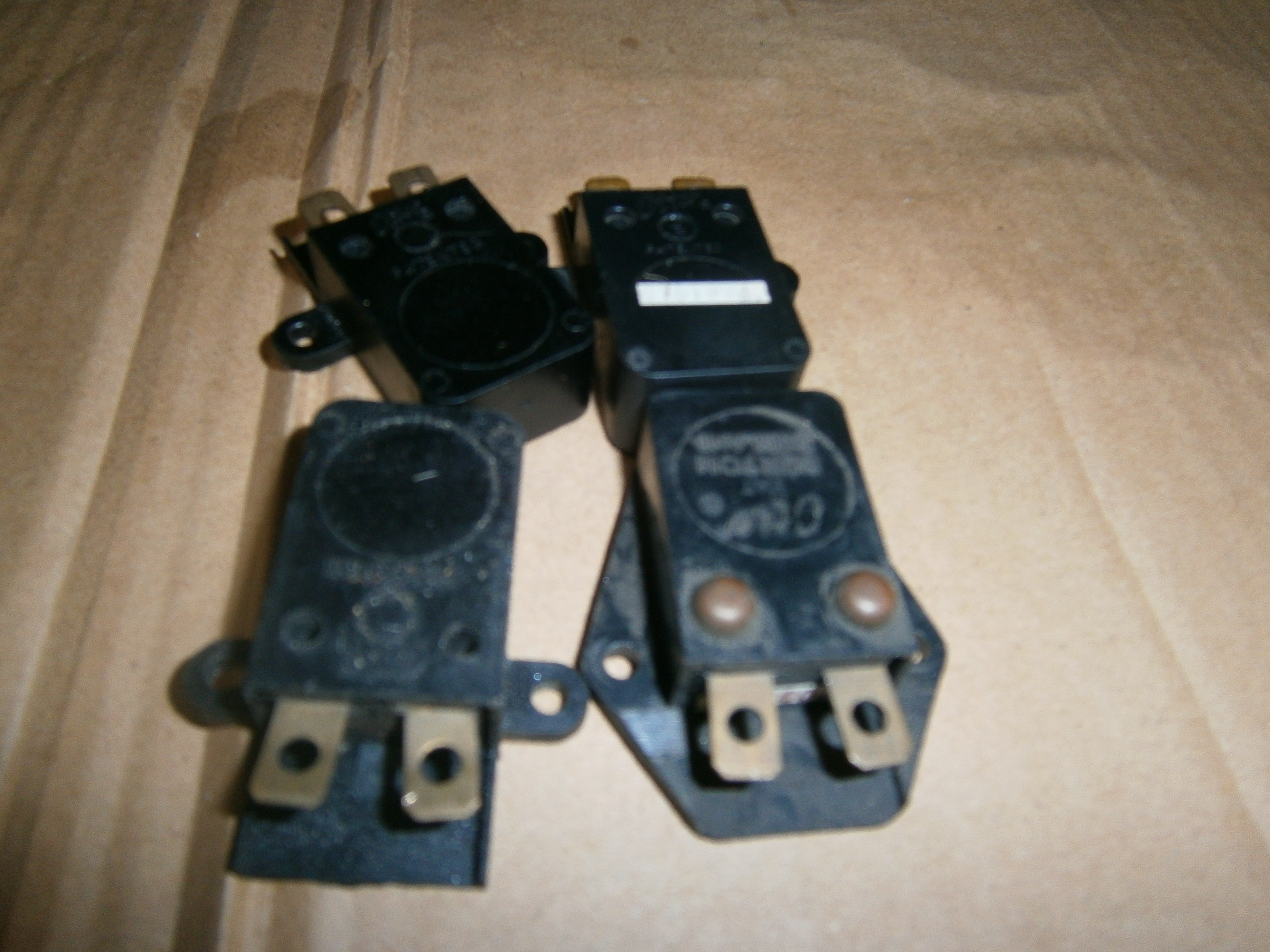

Anybody know what these are for.
I found them during the massive clean up.
The only thing on them is "Otter", which I am familiar with on the early electric choke Jags, but they look nothing like these.
They are new, but i am stumped.
Thanks in advance.

They are the current limit switches (thermal circuit breakers) for the windows on jag models like the Series III.
I have a few brand new ones still in the packages. I think they 'trip' at 30 AMPS.
The XJS has one for the Conv. top pump motor.
bob

Thanks Bob.
They appear new, as there are no marks on the blade terminals.
