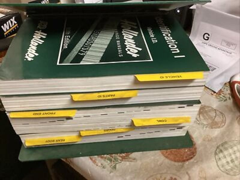

It's kind of changed over the years. We use to have the Hollander Interchange Manuals. These were very thick books every junk yard had on the counter.
Last one I see is the 65th edition that came out around 1999.
They still are in business but it looks to be some kind of electronic service now. I think the 65th edition was the last printed version. It's been many years since I have looked in one so not sure how the coverage is for later model cars? Or if individuals can get access.
very interesting, here in Italy I had never seen this type of manual! It seems to be very interesting, I could pass a lot of time on it!

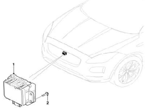

Here is what your looking for. This is all from JPART. Jaguar does all part numbers based on the last 6 digits of your VIN. So when looking for parts be sure and include that with your car details.
Now looking at this part it does not mention any VIN's so the same module is used on all E-Pace.
Here is the part number;
You do have the correct part number so keep searching for that.

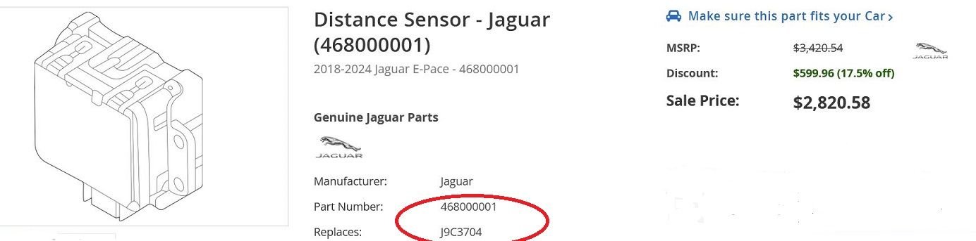

Coming back to the front radar: ok, it seems that for all the E-Pace the only part number is J9C3704, but, so why on ebay I can find the part number J9C3-9G768-AB for E-Pace MY 2017-2020 and part number MK72-9G768-AG for E-PACE MY 2021-2024?
Many thanks

Hey Luca. I don't know but if you post to the forum for your car you will have better results.
But since they show different years I think JLR made some changes after 2020? Also note the source? Ebay is full of junk yards and they only know what's printed on the parts. They don't do any research. You need to check any part number using a JLR web site and the last 6 digits of your VIN. BUT again it seems that they are all the same. Now I do see they have superseded the part number I posted above. This is another reason to ALWAYS check part numbers against your VIN!
That new part number 468000001 is a very strange number for JLR but note it covers all 2018-2024 models.
And WOW what a price!
