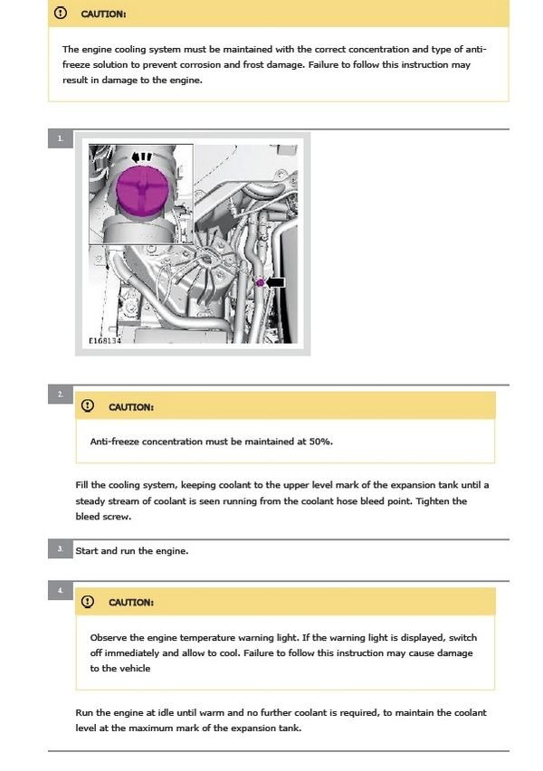

Welcome to the forums habilben,
Basically it's slowly fill the reservoir to the neck and open the bleed point to allow air to escape. Where the bleed point is located depends on the engine variant ......

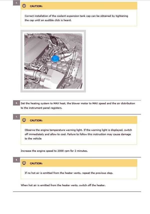

Which engine is this?
All the air will not come out automatically. That is the reason for a bleed point. I've taken the 2.0 litre petrol engine cooling system as an example here but you will normally find the bleed point is at the highest point in the cooling system hoses.
Be careful releasing the expansion tank cap if the engine is not completely cold or hot coolant can be forced out under pressure.

Air in the cooling system is removed at the bleed point on a coolant hose in the engine compartment, not one of the air vents.
