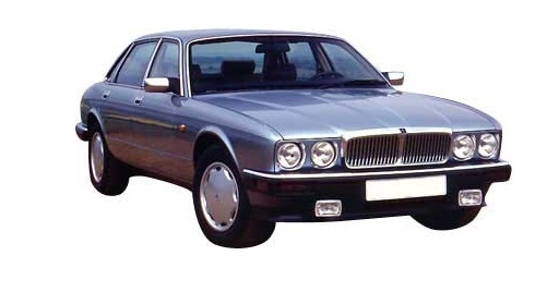

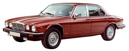

gooner,
I see you've previously posted in both XJ6 Series I, II & III and XJ40 tech forums. I think you have a Series III .........
......... and not an XJ40
Very confusing as Jaguar badged both models as XJ6 Sovereign!
Please confirm the model and I'll move your question to the right tech forum.
