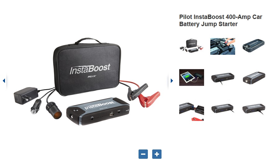

I would like to get a conversation going about jumpstarting your car. It has been identified several times that jumpstarting a Jag is not a good thing to do. Now I know that we have a right and wrong way to do it and maybe that needs to be discussed. The reason I ask is that I was in Lowes and saw this unit “Pilot InstaBoost 400-amp” car battery jump starter and I want to see what input I get on this. I like the idea but do not know the possible effects.
Link http://www.lowes.com/pd_573361-74342...Buy_Now_Search

I've taken a screenshot from the Lowes link you posted to make sure the 'InstaBoost' info is available if the link disappears:
We have similar devices available in the UK. Be interested to hear if anyone has used them.

So what is the right way and can a unit like the InstaBoost work? I need to reread Thermos post.

This leads me to the portable booster you can install the cables correctly (it has a reverse polarity indicator) and press the button to provide power when you are ready (no power connection when installing the cables) when it is in place you push the button and you start the car. I think it is a clean and accurate way to go. However I am not totally convinced and that is why I want an open discussion.

Does it have an option to connect to the battery prior to starting after the cables are installed?

While those little batteries, like the one Gus linked to, are a wonder of battery technology, their usefulness as advertised is questionable. Even the tool guys that come around to the dealership hawk these 'boosters'. Think about it, even the documentation that comes with them states they will recharge a smartphone 4 times, and the current iPads just once. I hardly think four smartphones will jump start a car. :-) On the other hand, as a test, we did jump start a few cars with this thing. But the only car that SUCCESSFULLY jumped, was at an ambient temp of 70 deg. F., and the battery was GOOD, just discharge to the point it couldn't start the car. Any car that actually had a failed battery, or was at low temps, was a lost cause.
So, in my mind, I'll spend a couple hundred bucks and get a booster like a Jump-N-Carry JNC-660 that will truely do the job. I think it's rated at 1700 peak amps. Works great.
