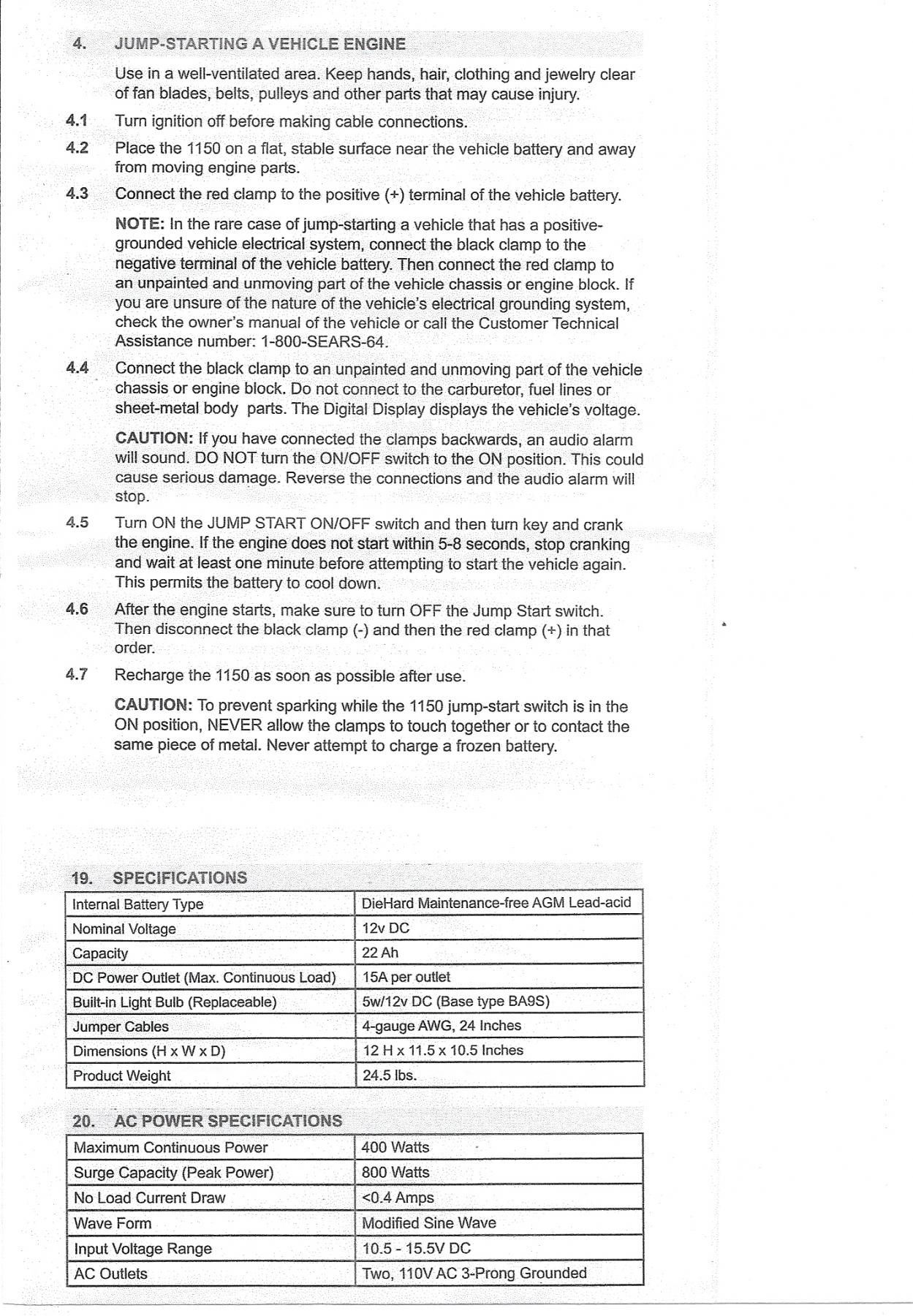

Yes. there is an off/on switch to allow you to connect first.
Actually, the unit I referred to does not have the isolation switch, clamps are hot all the time. The JNC-660 is a powerful, no nonsense booster intended for just that. Some people don't care for it because it doesn't have the idiot-proof features, or it doesn't incorporate a compressor or other bells & whistles. That's why I like it. I want one thing, the most boost for the buck. That's why I started my post with, "lots of opinions.......... here's mine."
It has a gel battery, so it can lay over without having to worry about the battery, it has a float charger, so it can be left plugged in without worrying about overcharging, and it works.
And looks like there are some better prices out there than I thought:
Edit: Oh, if you are not in California or Oregon, avoid the JNC-660C. It is required in those states, but it has "green" features that gut the power of the internal charger.

Those "booster" packs are just that, a booster. They are meant to take a battery that is discharged and provide a second means of power to give the vehicle just enough power to get the starter to roll. They are not meant to take 100% of the starting surge. They may provide say 50% of the starting current, but it is still relying on the installed battery to provide the other 50%.
Now, you get the ones that plug into your cigarette lighter, now you are looking at something that is really meant to only be a helper. Keep in mind that at best the kits like this can provide is 20 amps. When a starter will put over 100 amps, how much is it really helping? Yes, it may be just enough if you are at the ticking stage or if you simply plug it in and let it set for say 30 minutes so you can transfer the charge from the booster into the main battery.
If you want a booster that is worth anything (atleast in my opinion), the test that I would use is to completely disconnect a battery, put this booster in its place and see if you can start the car that way. If you can, then that is a booster worth the money. Granted, this is also just one more thing that you would need to do "monthly maintenance" on if you are keeping it in the trunk of your car as any battery will loose its charge over time. So, you would need to say once a month to put it on a charger to keep it near 100% capacity.
I still like the idea of the booster device if only we can find one of the proper load.
