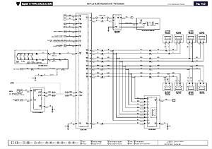

I would appreciate the help if someone could tell me the diagram of the oem stereo wires because I was changing the stereo on my 02 Jaguar x type and the wires were cut by the previous owner and then reconnected but the wires are exposing and I don't want a short circuit.so I was wondering if anyone knows a diagram of the OEM harness so I could connect my stereo directly with out a adapter.thanks

Old Nov 30, 2017 | 03:31 AM
Originally Posted by Elias Jr
..... the wires were cut by the previous owner .....
Butchers doing 'upgrades' really annoys me. Some of the worst are even in the vehicle audio trade.
There's two sound systems in the X-Type. You don't yet have sufficient posts to download files from the forum so I'll try the schematics here as JPG's:
STANDARD
PREMIUM
Attached Thumbnails Need help installing a after market stereo without adapter.-x-type_1.jpg   Need help installing a after market stereo without adapter.-x-type_2.jpg
