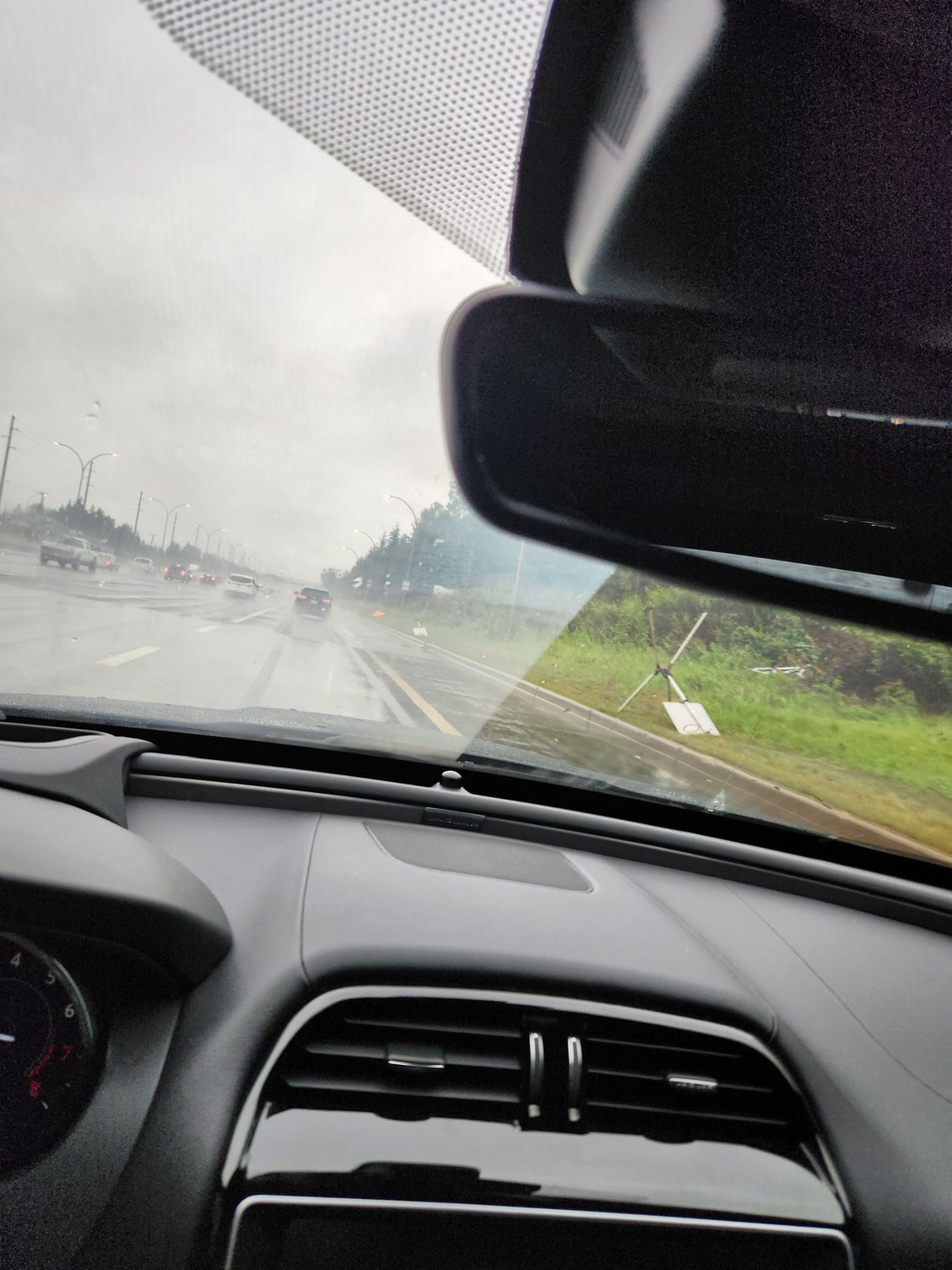

The drivers side wouldn't de fog with the heat turned on... is it dead, or just a fuse?

Cheetah, odds are, it is a fuse. Normally glass heaters like this are numerous wires running in parallel. So, you would have to break a lot of lines to cause what you are seeing. That would be a hell of a crack in the windshield.
