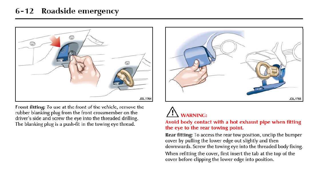

Jaguar use the front and rear towing eyes for tying down vehicles during shipping so this has to be the factory recommended attachment points:
There should be one towing eye in the toolkit - the other is discarded by dealers during PDI.
The following warning is given in the Driver's Handbook:
If the vehicle is being transported on a trailer or vehicle flat bed transporter, the parkbrake must be applied, the wheels chocked and the gear selector lever moved to position ‘N’ or ‘D’ but NEVER to ‘P’. The vehicle must be securely tied down to the transporter or trailer.
I'm not sure why the transmission should not be in 'P' unless there is considered to be a risk of breaking the transmission parking pawl if the vehicle moves.
