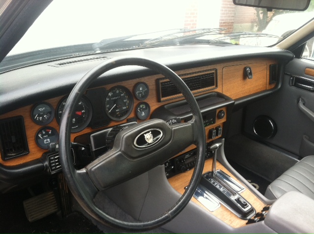

I will try to attach a pic of my car's wood.
Apparently the finish is completely gone, but it's amazing how even and undamaged it is otherwise.
How difficult is it to remove the dash wood for refinish?

You've got one of the [what I call] straight-grain dashboards seen mostly on 1985 cars. Typially the Ser IIIs have wood with more of a "burl" appearance.
It almost looks as though the dash has been refinished to "matte" versus gloss. The center a/c vent looks like it's had a bit of custom woodwork as well.
Anyhow, removing the dash is perfectly DIYable. Plan on about 8 hours for removal and reinstallation.
When you're ready give a shout and give you a step-by-step. Or at least touch the key points. It's been a few years since I've done one
