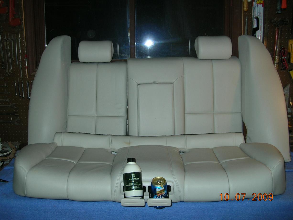

Ok fellows, Joyces Jag had its share of beach trips this summer and that means dirt, grime and sun tan lotion on the hides. I talked with ken@britishparts.com and he recommended the Connolly leather cleaner, followed up with Connolly hide food. Well heres the proof as what I found so far.
For the general clean up, the concentrated leather cleaner worked well with the directions of 1 part cleaner to 12 parts warm water using soft cloth, followed with damp cloth (clean water) then dry soft cloth to dry and polish.
As seen in attached pics the seats were in pretty disgusting condition (I know, I know) a (soft) scrub brush was needed. The cleaner was NOT a wipe on and wipe off for those. But the seat backs, bolsters, head rests and door panels were. It did not remove what appears to a stain from the middle seat belt.
I have yet to apply the hide food. That will be done tomorrow, with more pics to follow.

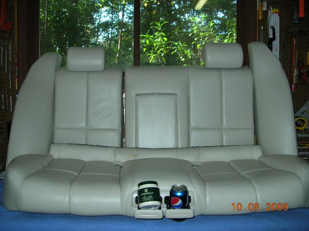

Here we have the hide food setting for 1/2 a day per what I have read on the net. The instructions on the tub of hide food were vague to type the least. Hand buffed with terry cloth and then I decided to low speed orbital buff them, WOW what a difference!
If anyone has any ideas on how to remove or cover the stain on the lower left drivers rear seat back. I am open to all suggestions.
Attached Thumbnails skinny on Connolly Leather treatments-low-speed-buffer-installed.jpg   skinny on Connolly Leather treatments-hide-food-buffed-1-.jpg

Connolly Hide Food has parafin in it and should be warmed before applying it and then put the car in the sun to keep it warm, or it will not absorb into the hide. Polishing it in a cool state just puts a glossy shine on it and doesn't really help the leather softness. It needs to be warm to be effective.

Connolly should have stated that and other directions for use as well. Question though, if it is absorbed into the hide and after buffing will there be a soft shine? Oh and how often to apply the hide food and is it more times the better kinda thingy?

Connolly has been around so long that they really do not have any instructions on how to use it. I would not use it more than once a year. It basically is a leather surface protectant, i.e. a surface sealant. If you are looking to soften old leather, I recommend treatments with Leatherique Rejuvenator. All leathers will absorb better when it is warm.

Well the final judging is in. Joyce got into her vehicle first time in 5 days. She could not believe that the interior was not replaced, "looks, smells and feels like a new vehicle". "I love you"
