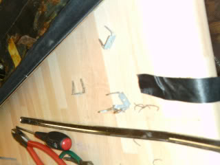

The first job was to remove the carpet. This was held in place by a LOT of glue and some nasty rusty staples.
The chrome bar also had to come out, and this was held in place by some clips on the back of it that were very easy to undo.

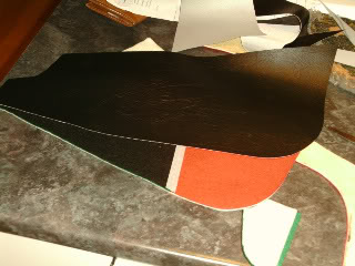

Once the carpet had been removed I could measure up for the felt backing and PVC topper and made a little template to ensure it all fitted together.

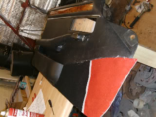

The felt I cut right to size so it fitted edge to edge to ensure the padding was even all over, and stuck this down with some industrial spray glue.

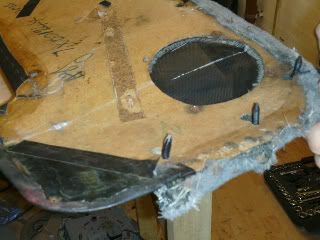

I tucked the top of my PVC cut out (which had been cut oversized on the overlapping edges) under the felt to ensure that there was a nice finish, and before sticking the rest of the PVC down I put the chrome bar back in place to ensure it held the edge down so that I could pull the rest of the PVC over the felt backing. Once down on the front I turned the door card over and spray glued the over lapping edges, then stretched them right over back of the door card to ensure it had a nice finish at the edges and was stuck down well at the back. I didnt use staples in case they came through the wooden card.

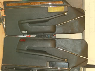

New Vs the Old

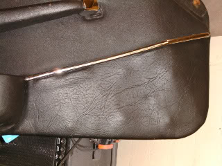

The New Look
