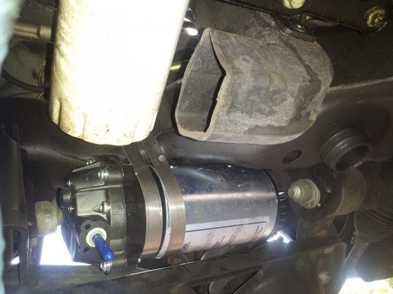

Hopefully some one finds this post helpful:
I'm in the process of installing a Snow Stage II dual nozzle alcohol/water injection. Please see the photos of how I did it, and where I located the solenoid, pump, and nozzles.
I used the stock/factory windshield reservoir, but I added the low level sensor that came with the injection kit. That is the larger black round thing part way up the bottle the side.
To make the space needed for the new 3.5" cold air intake with huge K&N like filter, I simply cut off the tube which comes out of the top of the reservoir and found that a 1 1/2 PVC 45 degree slip fitting fits in "really tight." It is in as a friction fit, and when my intake arrives, I will simply rotate/swivel the 1 1/2 pvc pipe with 45 degree angle fitting filler tube for easy filling.
Since I'm injecting after the blower, I'm also using the solenoid to prevent siphoning at idle, the solenoid is located before the pump. I'm starting with 2 225 ML/MN injectors. The nozzles (tapped into the blower cover) swivel, so the red lines can be run over or under the charge coolers.
There wasn't a lot of room down there, so please comment on what you think of my choices of mounting locations. I used two 6" hose clamps to mount the pump to the frame. It is super solid. I used 2 clamps for peace of mind. One would have been plenty. The solenoid is double zip tied and and wrapped with copper wire through a hole in the frame. All the tubing bends are gradual with no stress to kink any lines, despite how some photos may look.
Please have a look at the photos and tell me what you think

Attached Thumbnails Snow Stage II water/alky injection install part 1-2012-06-22-18.16.10.jpg   Snow Stage II water/alky injection install part 1-2012-06-22-19.43.10.jpg   Snow Stage II water/alky injection install part 1-2012-06-22-19.47.00.jpg   Snow Stage II water/alky injection install part 1-2012-06-22-20.05.52.jpg   Snow Stage II water/alky injection install part 1-2012-06-23-14.15.31.jpg
Snow Stage II water/alky injection install part 1-2012-06-22-20.06.17.jpg   Snow Stage II water/alky injection install part 1-2012-06-13-20.11.34.jpg

Nice install WaterDragon!

I tested the kit today with water only (using a temporary always live power source) and it appears to work well.
I filled 1/2 tank of 87 octane instead of my usual 91. The car, even with water only, felt a little stronger. When I turned off the water injection and was running the 87 octane the car had significantly noticeably less power.
I'm running 2 of the 225 ML/MN injectors. I set the system to come on at 2.5v and full at just over 4 volts on the settings on the control box.
I am running stock pulleys, so stock boost. I'm planning on running a baseline 1/4 mile at the local track on Weds, but not with the meth kit, just engine only with 91 octane fuel.
After I get the 4 lb lower pulley installed I will run the car again on the dyno and 0-60 and 1/4 mile and will post my results.
