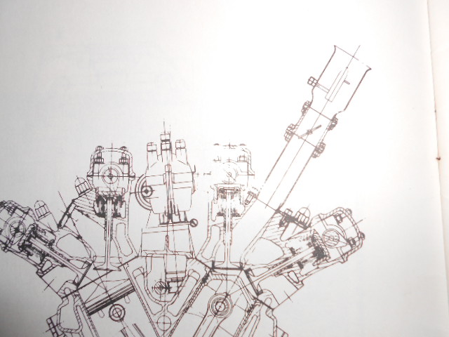

found this old pic from Jaguar archives, for XJ13 engine,(you may have seen it already).
nice shape to ports, long ram length, injector at trumpet neck, and throttle plate, most important a straight shot to the valve!
some small mentions about your project.
1st it is very pretty, and impressive when you open the hood/bonnet! altho most would not know what thet are looking at.
2nd i'm all about smooth flowing inlet ports, yours would have some disruptions when flowing past the curves and joints, any thing that forces a change in flow direction,would slow velocity, and produce some tumble in ports, and that could effect cylinder filling.
but i do understand, it has to fitt under the factory hood. i'm not sure as a BOLT in kit?
there are some engines that use ITBs(Nissan RB26 turbo), but tests have shown ,custom large plenum with internal trumpets, and a large single TB, actually produce more power and easier to drive smoothly, along with favorable emission results and better MPG.
BUT it just dont look KOOL,or pretty.
i drove a Nissan with the ITBs, and throttle response was like an on/off switch, that along with a triple plate clutch,(NO slip,in or out), was almost dangerous in traffic, trying to get moving and not bump the car in front of you!
anyway like said its just a thought, an old hotrod saying,(if it dont go fast make it look good).

Default pic
jag pic XJ13 inlet port

it still looks beautiful even being close to 50 yrs old!

would you like to have a gander at this PDF on Bell mouth shape....
while reading it I now understand why injectors on the x13 proto-type were placed where they were...

that is the most comprehensive bell mouth essay i'v ever read thanks!
