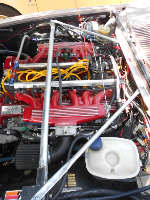

i use 3MM oversize valves in my 1978 5.3 engine, ported& smoothed!
i'm sure the inlet is close to the bore, but have no problems with contact(hindsight could have notched the top of bore).
springs are a new set of factory, with a 060. shim, revs past HP peak(7000) , cams are Crane #2 race profile, pistons 9.2-1 pre HE.
20yrs and counting! plus some mods that i'v forgot about.
also Jaguar valve train system(cam on bucket), needs very little spring pressure,dont waste power opening valves, (it aint no push rod motor).
Attached Thumbnails valve springs - 5.3L v12-jag-strut-brace-mom-ridin-shot-gun-v12-exhuast-mani-001.jpg
