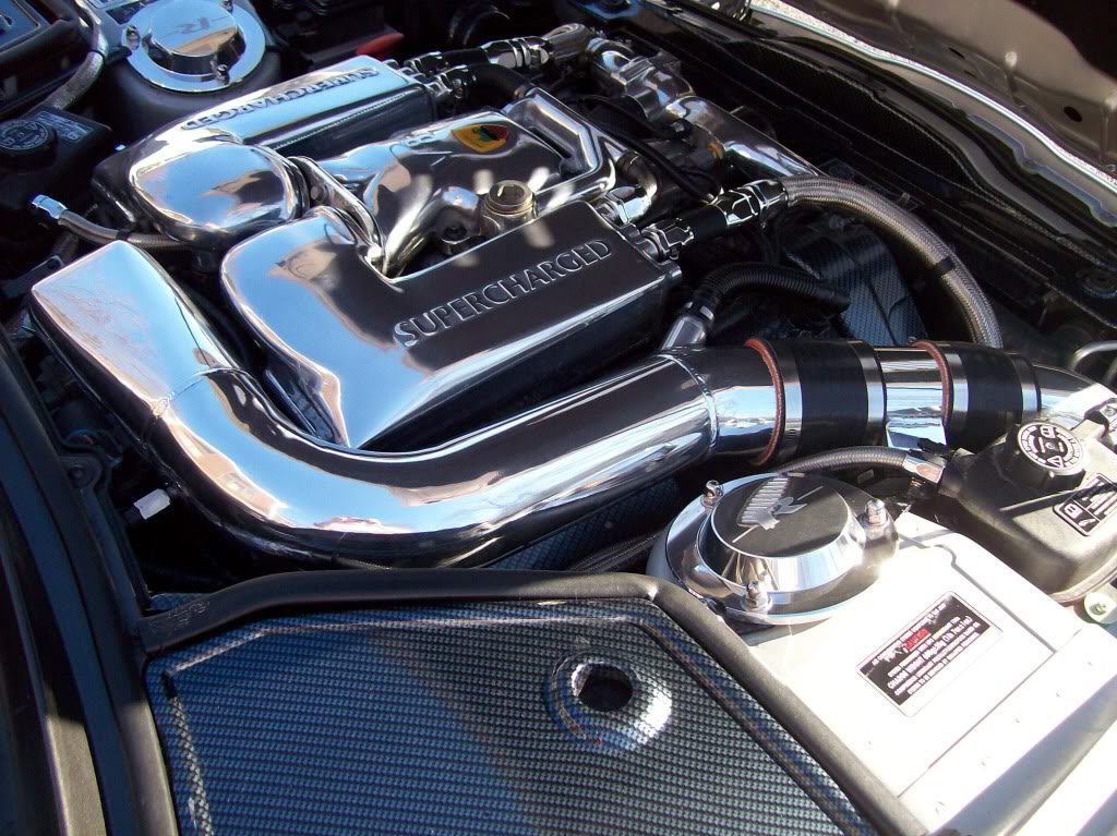

I have had the Snow Performance system installed in my car for over 2 years now & love it. They offer a remote resevoir but also give you the option of using the washer resevoir. The Jags with headlamp washers have a 7 liter resevoir & also a built in low fluid level warning. I have a small light mounted on the a pillar next to the boost gauge which shows you when the system is activated as well as a switch in the car to turn it off. The nozzle is mounted app 6" from the throttle body. You will love the increase in power. Be careful in the very cold weather, on a cold day driving on the highway with the system on I saw 22 psi of boost, that was more that I wanted so it was nice to be able to turn the system off. If any of you look at Roadfly you know of Monster who has a highly modified XJR he has also fitted the system & was quite impressed. Good luck with your install.

JAXKR could you please post a pic of the nozzle, more important were ir was mounted. Thank You.

The nozzle is app 6" from the throttle body on the firewall side

sexy engine bay JaXKR
Old Mar 9, 2010 | 03:59 AM
Cadillac's Avatar
Posts: 11,393
Likes: 649
From: Planetarium
What an engine bay ,looks gorgeous in every way

: icon_imnotworthy::icon_imnotwort hy:
WOW!!! That's all I can say. WOW!!!

Who makes that intake?

Thanks and that is a beautiful engine bay. love the R caps on the strut mount
