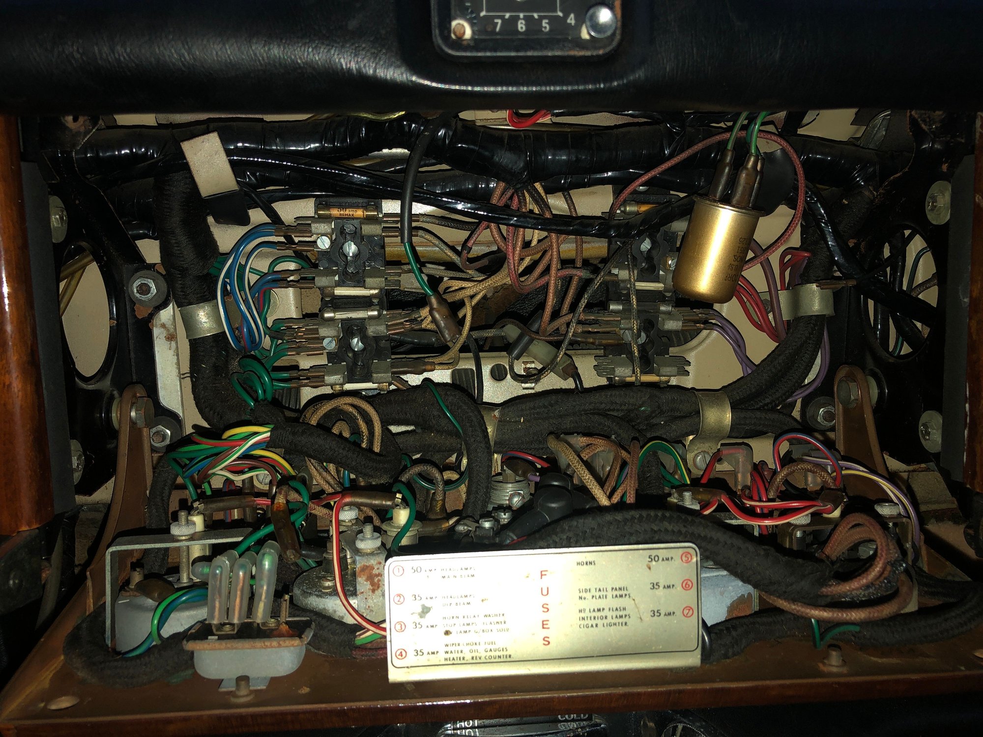

I did use a pressure washer. Looking behind the center panel inside the car it appears there are some things disconnected. I suppose figuring out what goes where wouldn’t hurt either.

Alright everyone I think I'm getting closer. Seems like the ignition relay may be to blame. Anyone have one of these go bad? Looks like it's also a window lift relay for other vehicles. I'm speaking of the part that has the wire clip holding the plastic cover with "C2/C1 / / W1/W2" stamped on it.
