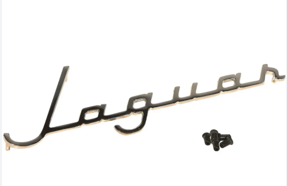

Does anyone have the parts book for a 1955 Jaguar MK VII M? If so, can you look up if the MK VII M had the "Jaguar" script boot emblem as an option or if it was only offered on the later MK VIII? There is a lot of conflicting information out there and I assume the best place to get confirmation is in a parts book. I have one and would like to install it on my VII M but will not if it isn't correct. Thanks!
