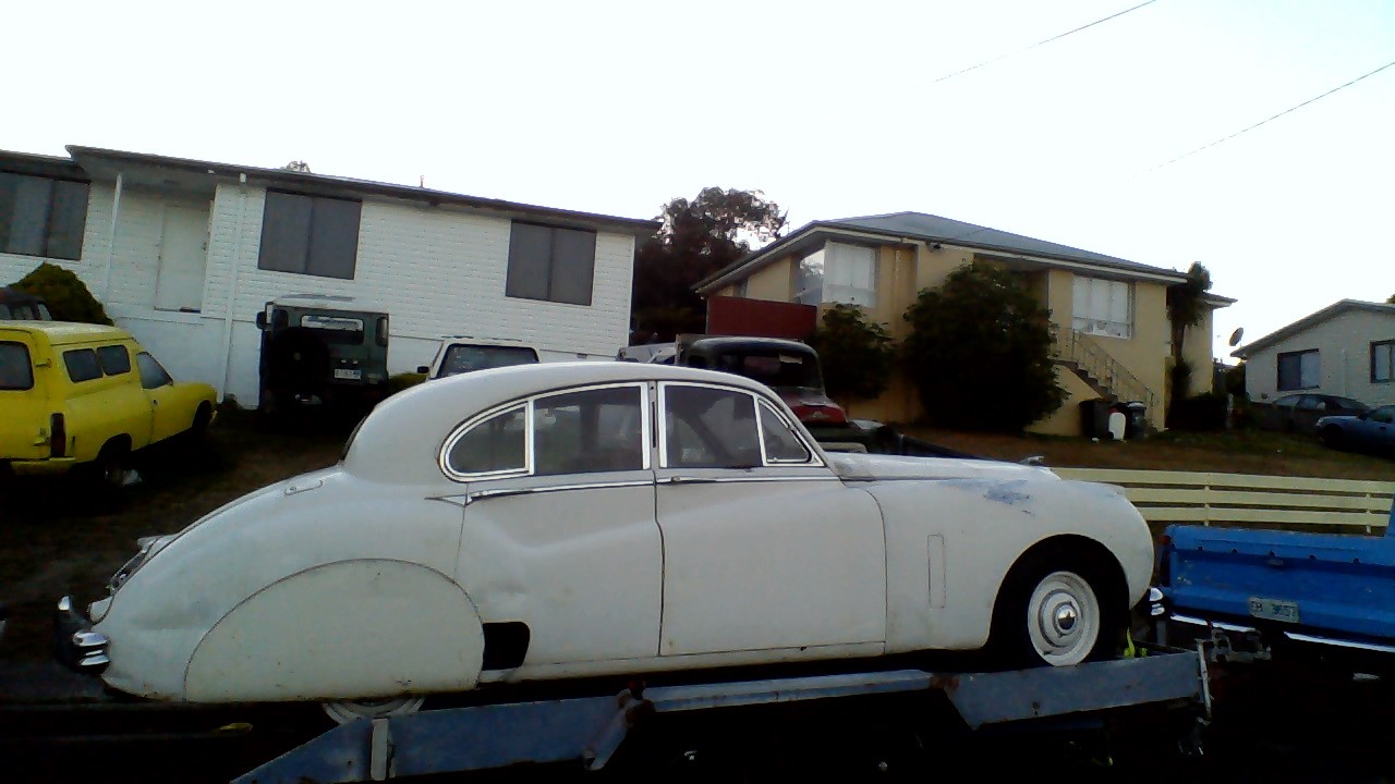

Hi...quick question.
My mk7 has been parked for many many years..im currently sorting out some lucas gremlins which ive covered in my thread in the "introduction" section.
ive wound it over on the key plenty..both with plugs in and out...but the oil pressure gauge wont even flicker...oil is clean,but i havnt replaced it with fresh stuff yet...is there a trick to get oil pressure up before startup?..ive had to drop the bottom cog off a holden v8 dizzy and attach my cordless drill to the shaft before to build up oil pressure in a v8 holden..do the jags work on a simalar principal?...any way to see if its just a dicky gauge?..I dont want to ruin my engine before project jag even starts
Attached Thumbnails Mark 7 getting oil pressure up-win_20150313_071235.jpg   Mark 7 getting oil pressure up-win_20150313_071222.jpg   Mark 7 getting oil pressure up-win_20150313_071210.jpg
