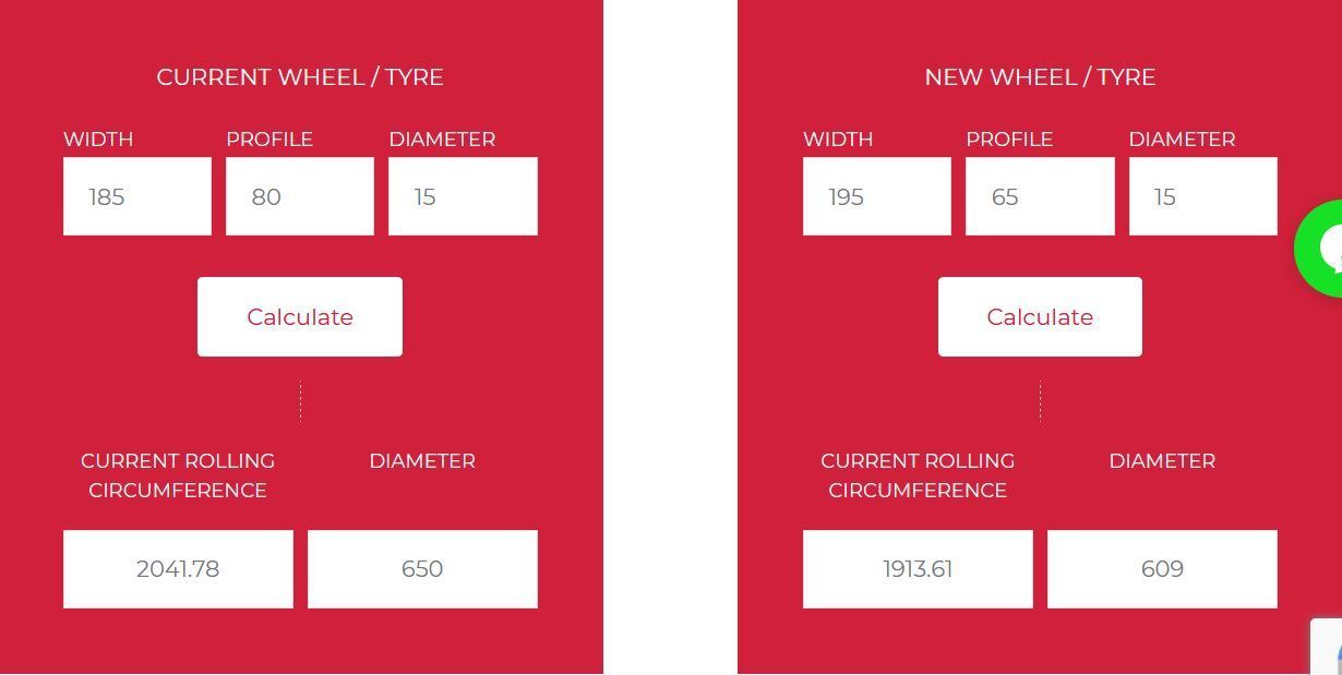

You need to keep the rolling circumference the same as a 185 X 15. (which BTW is an 80 profile). With a 195 X 65 X 15 your speedo will overead by 6,27%

See calculator above Jose or go to the Tire Rack & they show rolling circumference in many forms including Revs per Mile which will allow you to compare tyres fairly accurately as they test every tire & size inflated.

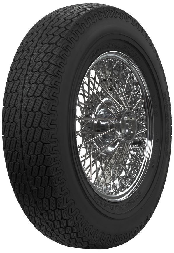

Jose, Longstone tires can put a white strip on any tire, he doesn't like to do it, but he will.
I have these on my MK II, they will fit the S-Type and look period correct.
(they're free shipping world wide for a set of 4)
180 R 15 Michelin XAS - 180 x 15 Tyres (longstonetyres.co.uk)
I was like you, accepting compromises because I rationalized that I didn't drive the car that much so I don't want to spend a wheel barrel full of money on tires.
In the end I was never really satisfied or happy with those compromises with modern looking tires with big ugly printing on the side or tires that just don't fit.
I wasted more money on tires that I didn't really like.
I should have just went for the correct ones on the first place.
We have old cars, expect to pay more for some things.

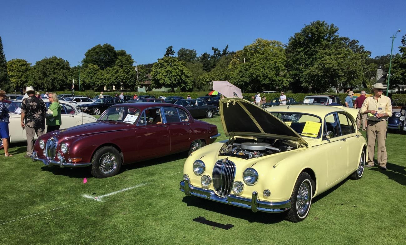

Originally Posted by Jose

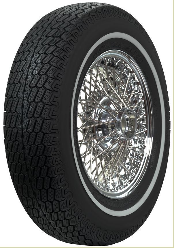

Glyn, Gregory's MK-2 has the tires I want.
His are the Universal Vintage Tires, in the original 185 R 15 size.
I have the same tires, but in blackwall, and I really wouldn't want anything wider. It would make taking the rear wheels on and off difficult.

Actually 232.00$ for those isn't that bad.
A standard Michelin tire for a modern truck is priced about the same.
185HR15 Universal Sport 5/8" White Stripe Tire (universaltire.com)

My car with blackwalls beside Gregory's Mark 2 with whitewalls at the Jaguars on the Island show in Victoria, BC.

Good. They are a nice tyre & look really good. They are HR Rated = 130 miles per hour which our cars won't do. They use modern construction technology. As I say they are 80 profile i.e. 80R. (Prior to the introduction of lower profile tyres so not stated ~ 80 profile was standard)
https://www.universaltire.com/univer...rt-radial.html

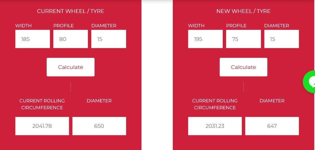

To add to Doug's explanation, the width is literally in millimeters or mm for short, so 185 mm.
The aspect ratio is a percentage of the width, but not the entire tire, just from the edge of the tire to face, so a 185/80 r15 would be 80% of 185 to get the height over-all.
So a 185/80r 15 would measure up at around 26.7 inches tall or 678mm and the width is 185 of course or 7.3 inches.
I used this tire calculator to plug in the numbers.
They're all over the internet.
So if you do that, you will find a 205/70r15 a little shorter and a 205/75r15 a little taller in over-all height when compared to a 185/80r15
The "r" stands for radial and "15" is the rim size.
Personally I think the 205's are going to be too wide and come too close the edge of the fenders, especially in the back.
A 195/75r15 would be a better match, but I don't think there is too much out there in that size.
As manufactures were moving away from tall thin tires, the 195/75r15 that was replacing the 185/80 series became obsolete as cars were designed with fatter and shorter tires.
There is a 195/70r15, but then you're getting to short, the car will sit too low to the ground and your speedo will be out too much.
Coker makes a 195/75r15 with a thinner white wall and it's not too badly priced at 164 US dollars.
If you go any wider then that, I think you're not going to be happy, it' just too wide to fit in the fenders of the car.
American Classic Radial | 3/4 Inch Whitewall | 195/75R15 - Tires (cokertire.com)

195/XX/15 is a size that is not well catered for. I can't think of a single car that had them standard. Even 180 X 15 was specifically for the Citroen DS family.
That Coker195/75/15 that Jeff suggests has close to original rolling circumference as long as you like what it looks like. Might be just what you want. Note that it is S rated 112 miles per hour max.
