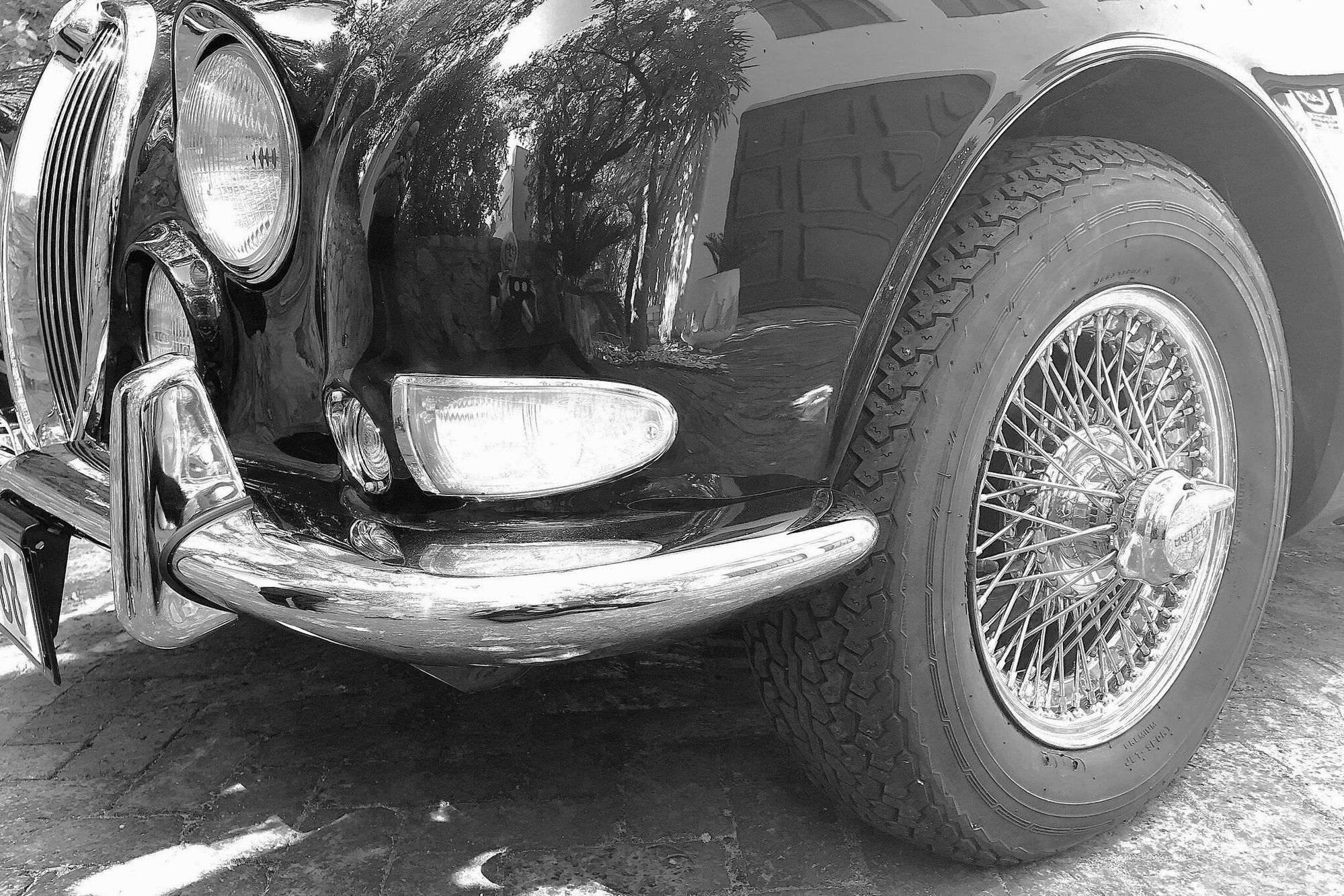

there is a big difference with whitewalls. The car looks a lot more classy and "formal" with whitewalls. With blackwalls it looks "sad". But this is only in the early Small Saloons. If you use whitewalls in the XJ, they don't look right. The XJ looks better with blackwalls.
Originally Posted by Jagboi64
My car with blackwalls beside Gregory's Mark 2 with whitewalls at the Jaguars on the Island show in Victoria, BC.

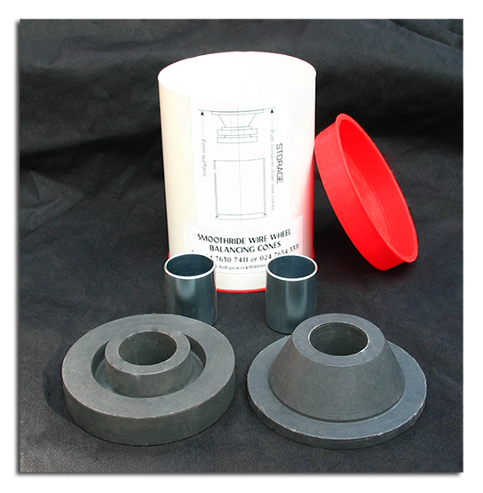

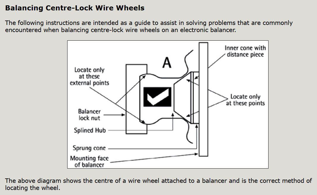

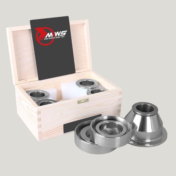

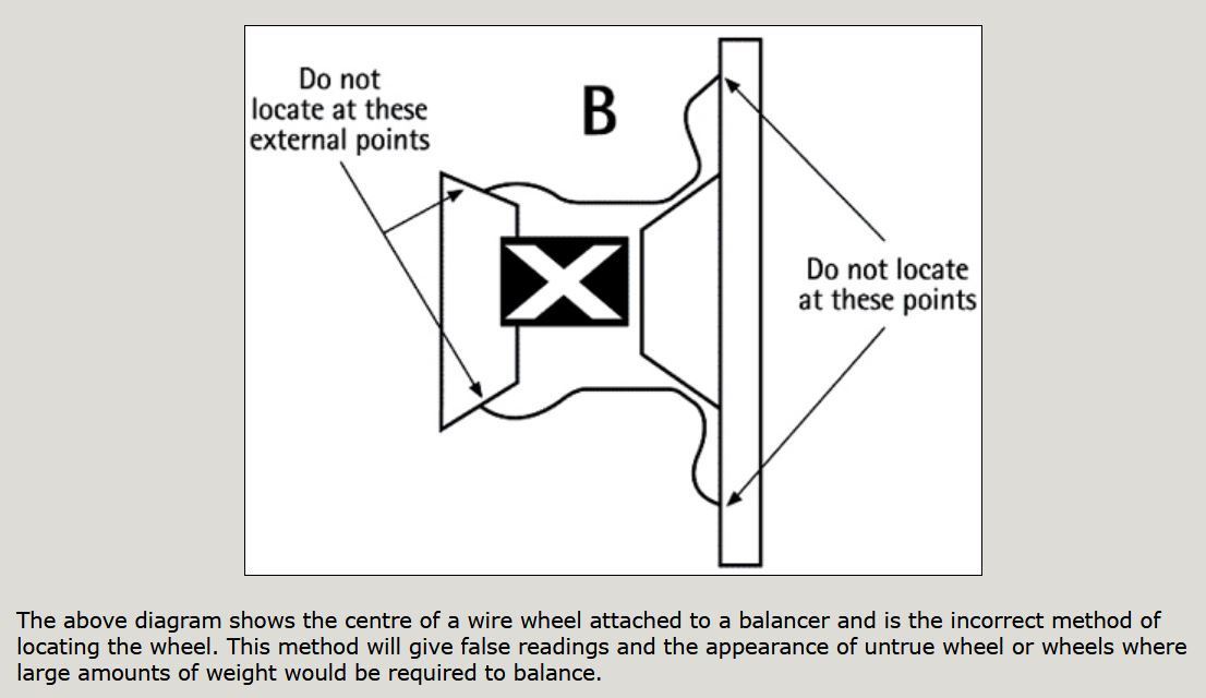

Any tire place should be able to mount tyre on wire wheels even with inner tubes but it is the balancing of the wheels that is difficult. Most modern garages do not hold the cones required to balance them and they cannot be balanced using a modern balancing machine as the contact between wire wheel and machine is in the wrong place. See Glyns diagram above. I bought my own cones a couple of years ago. Expensive but at least I know my wheels are balanced correctly as I take the cones with me so the garage can use them on their machines.
Old Apr 3, 2021 | 05:41 PM
  #36
Glyn M Ruck's Avatar
Posts: 5,546
Likes: 1,493
The cheaper ones like I have that are all you need.
The fancy kit from MWS ~ Really made for a balancing shop.
