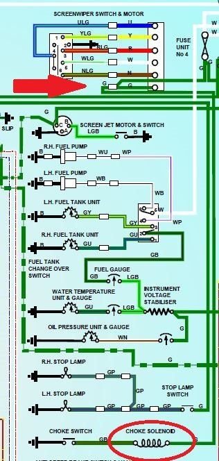

Why do you need a new Otter switch if you have a manual choke or is your manual choke a switch & not a slider?
AED diagram.

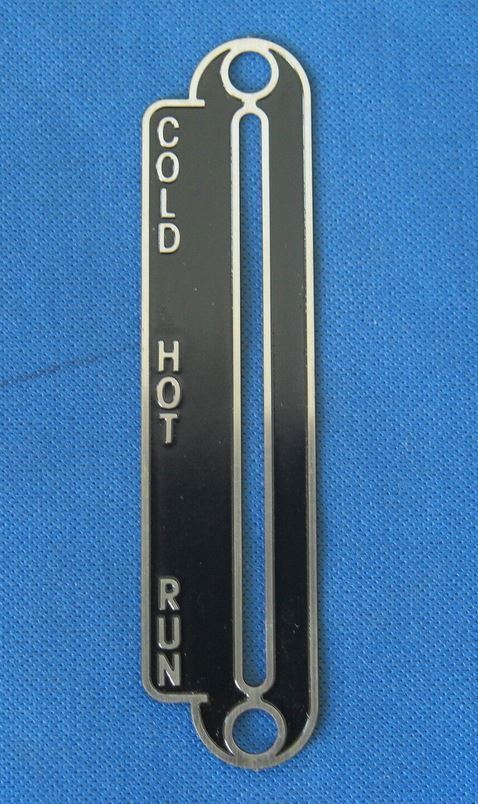

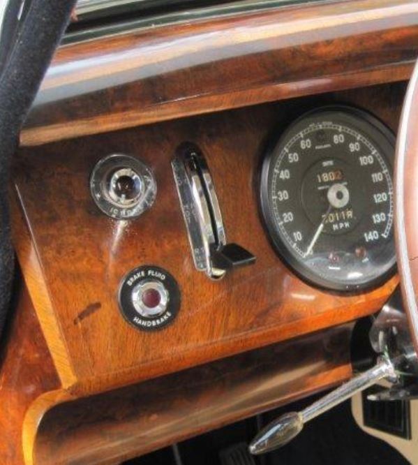

Glyn, that slider mechanism where it's labeled "HOT", where is there ever a situation that you have to have the choke on HOT, that' half way, isn't the choke still open ?
Where is there ever a situation where one would drive around with the choke half way on ?
I have that exact choke mechanism on my Bentley, it doesn't take long for the engine to be warm enough where I have had the choke on half way.

Originally Posted by JeffR1
If it didn't smoke after it started after 12 try's, it's probably not a choke problem (too rich), but we still need to know what kind of choke you have to totally eliminate that from the equation.
Jeff. I can't answer for Jaguar's chosen labeling. That's an E Type but they have always chosen that labeling.
Choke escutcheon.
