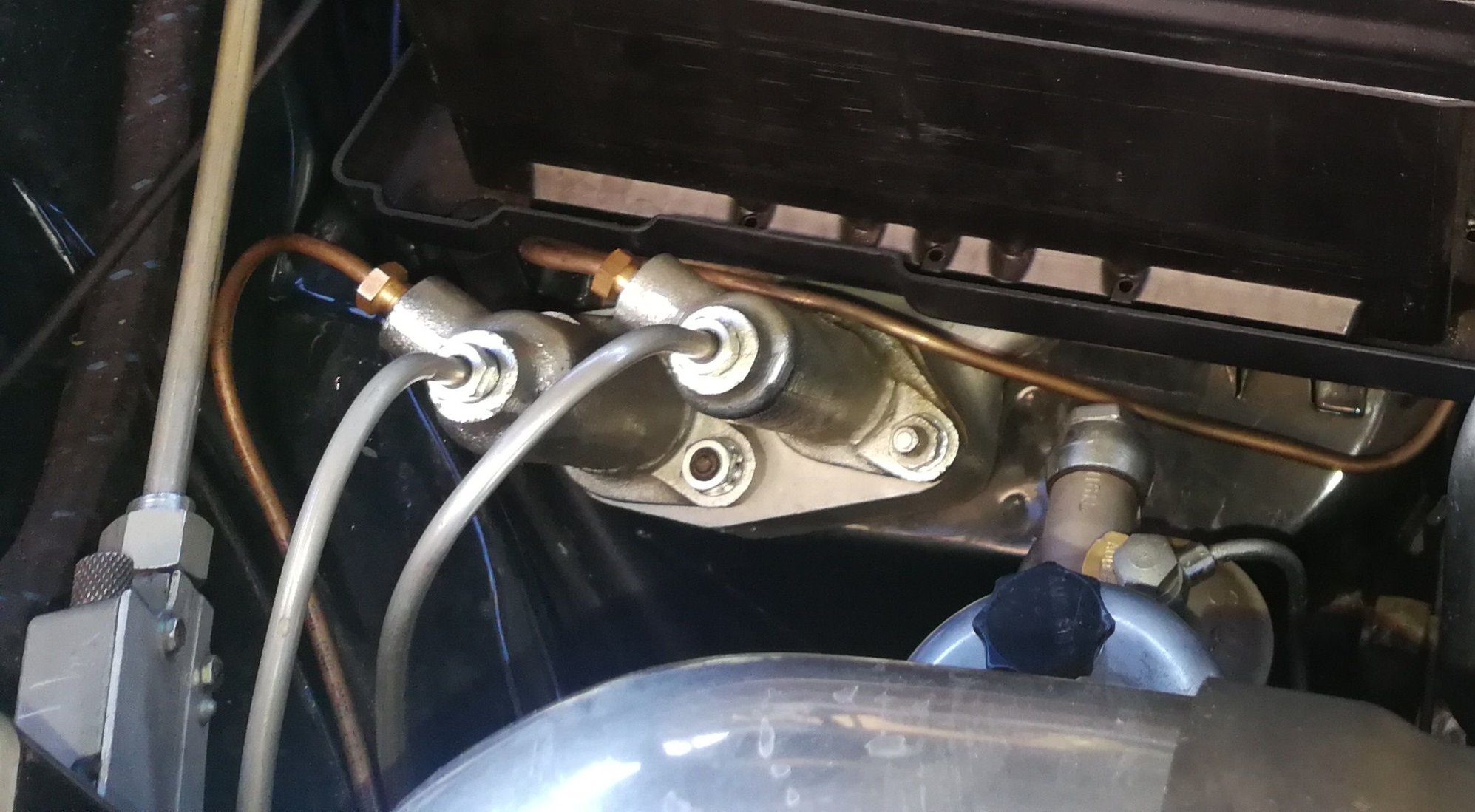

I have a Dunlop Brake Master Cylinder that is ceased. What is the best option? Rebuild kit, replace (Girling), SNG lists a Dunlop to Girling conversion kit, etc.. If replace how much modification is required?

I put a new one on, not sure what make it was but it had to have a spacer and longer studs

Most new brake master cylinders require some pipework re-jigging due to changed port positioning

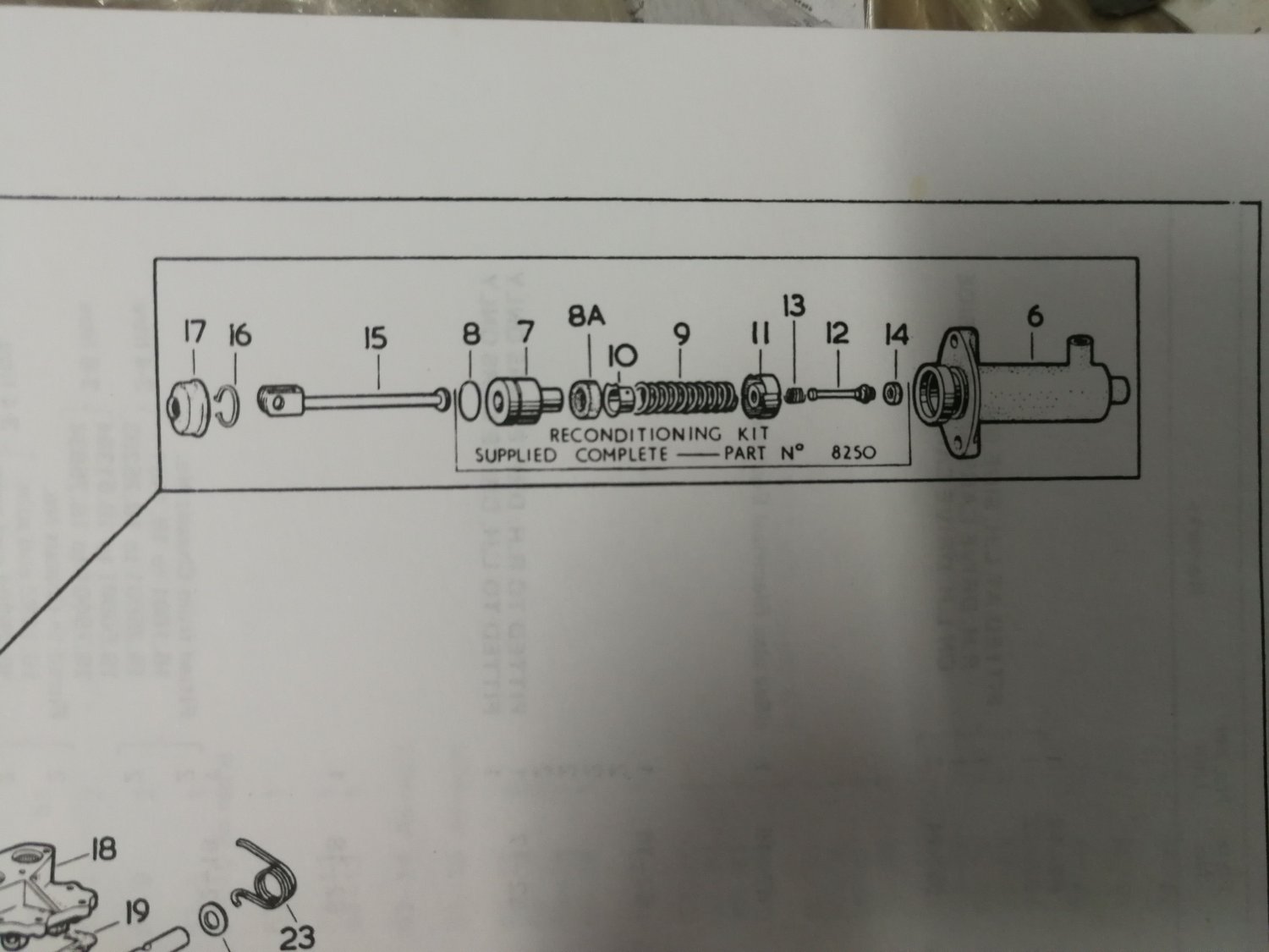

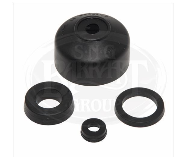

Thanks to Jeff I was able to source a Canadian company to sleeve the Cylinder, thanks Jeff! But before I go ahead I wanted to confirm what other parts I will need to rebuild once I get it back. I looked on the Moss Motors website and they show 2 items that look the same. I think it is the Seal Kit Dunlop Master Cylinder #605164. Does this seem right? Is there anything else I need?
Thanks again for all of the advice and direction, it is very helpful.

The guys that recon'ed/sleeved my cylinder for my late 65 S type had all the required rubbers.
The above might or might not fit. Looks very similar to mine.
Dunlop changed the Cylinder around your time & you need to check your VIN. They talk about red tags (page 25). My unit had standard metal tag like yours.
Read this Jaguar bulletin in detail re Master Cylinders. They are addressed a number of times amongst the other guff.

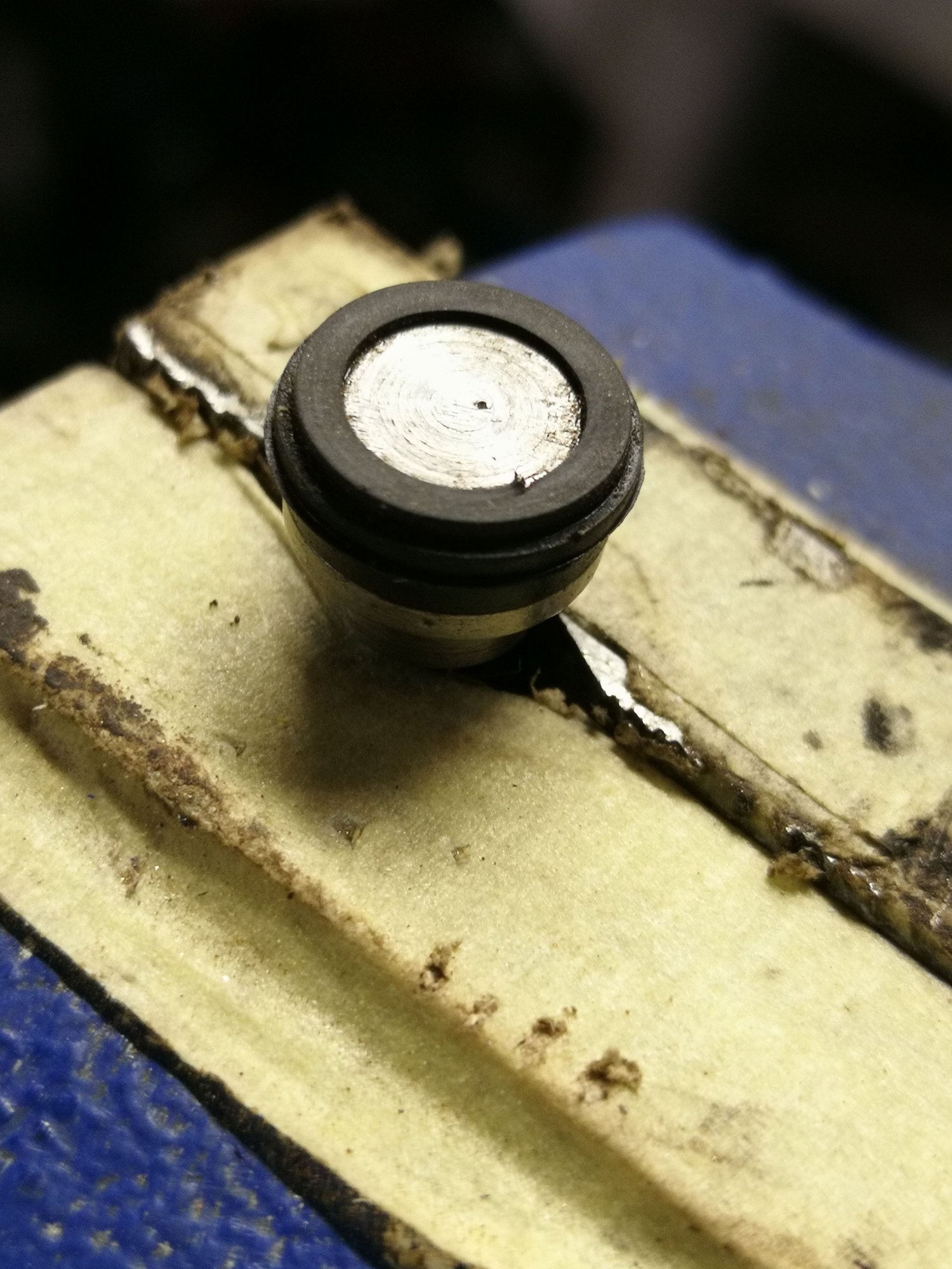

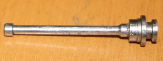

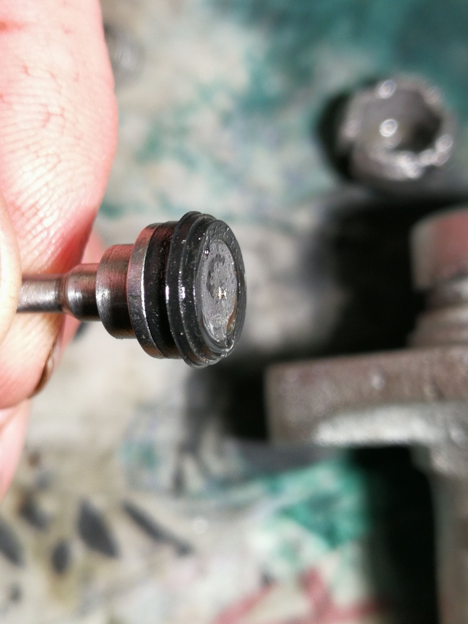

OK. Then you have the updated Dunlop cylinder like I do. The only slight issue we had was the latest inlet piston seals. They are all just marginally thin from multiple sources. Sometimes we had brakes & sometimes we did not. This was due to the seal sometimes not closing the inlet port & fluid returning to the reservoir instead of pressurising the brake system. Common issue.
Full update/reconditioning kit which we both have as per factory bulletin:
Inlet Valve piston. (the standard of finish on Dunlop braking components is atrocious.)
End of piston vs rubber seal ~ insufficient protrusion
We turned down the end of the inlet piston slightly to ensue adequate seal protrusion. Brakes perfect. Have checked many inlet port seals. They all seem to be manufactured slightly too thin.
Finished job for proper sealing..
