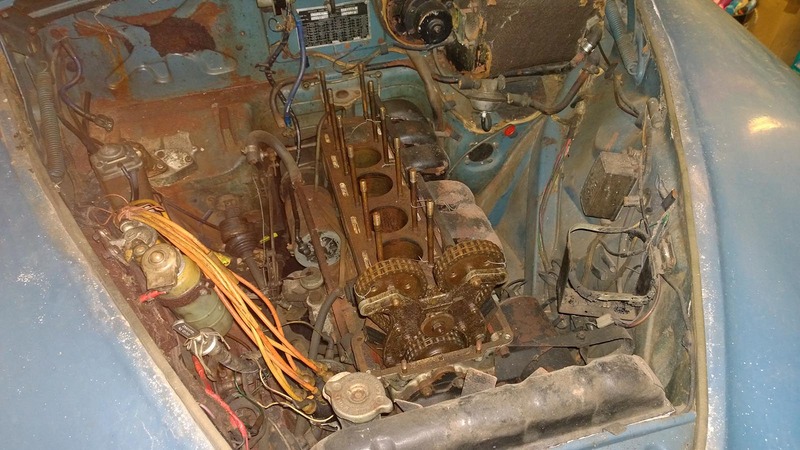

I managed to decode the numbers in the engine bay and it is indeed a 3.4 with the BW auto so nothing extra-special. Once I have the chassis number, I'll put it up on the register.
I've included a pic of the horror lurking inside the engine bay. Hopefully the electrics haven't been eaten somewhere. I pulled a cap of a fuel tank and oh boy, it smells like varnish. They're going to be fun to clean out and treat (POR15 on motorbike tanks has taught me a lot).
The father in law and I had a look over it last night. I think the more we looked the more we found, but nothing to weep over. The FIL is really excited as he had a bad experience with car restoration recently and lost his pride and joy to a shady panelbeater. Anyway, he wants to pull the whole thing apart and fix it up again bolt by bolt (which would take a decade on my budget).
If you're going to paint it, don't cut corners, nothing looks worse then a hokey paint job.
Remove the front and rear wind shield, trim and do the engine bay etc.
It's one of my pet-peeves is when the rubber windshield seal is simply masked off and you can see where the new paint has met up with it.
The seals probably need replacing anyway, I'm sure they're hard as rocks.
When you put the engine bay back together you can replace all the rotten grommets and paint all the bits that go back in.
It doesn't have to be concours, but there shouldn't be any rusty and dirty surfaces.
I know if you don't take care of the engine bay now, you will regret that you didn't.
The outside will look really great and there will always be this ratty looking bay.
It's very difficult to clean it up with the engine in place.
