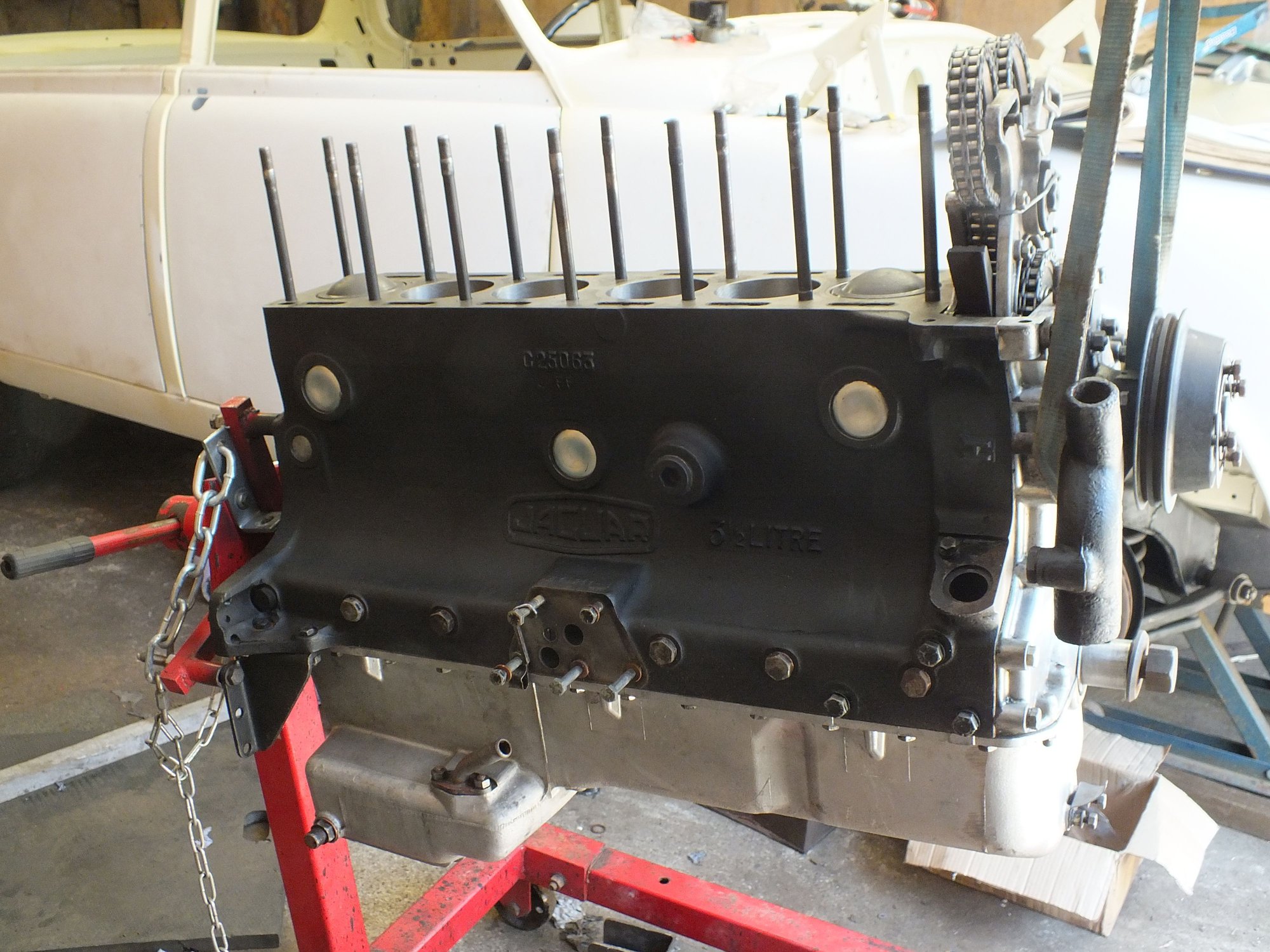

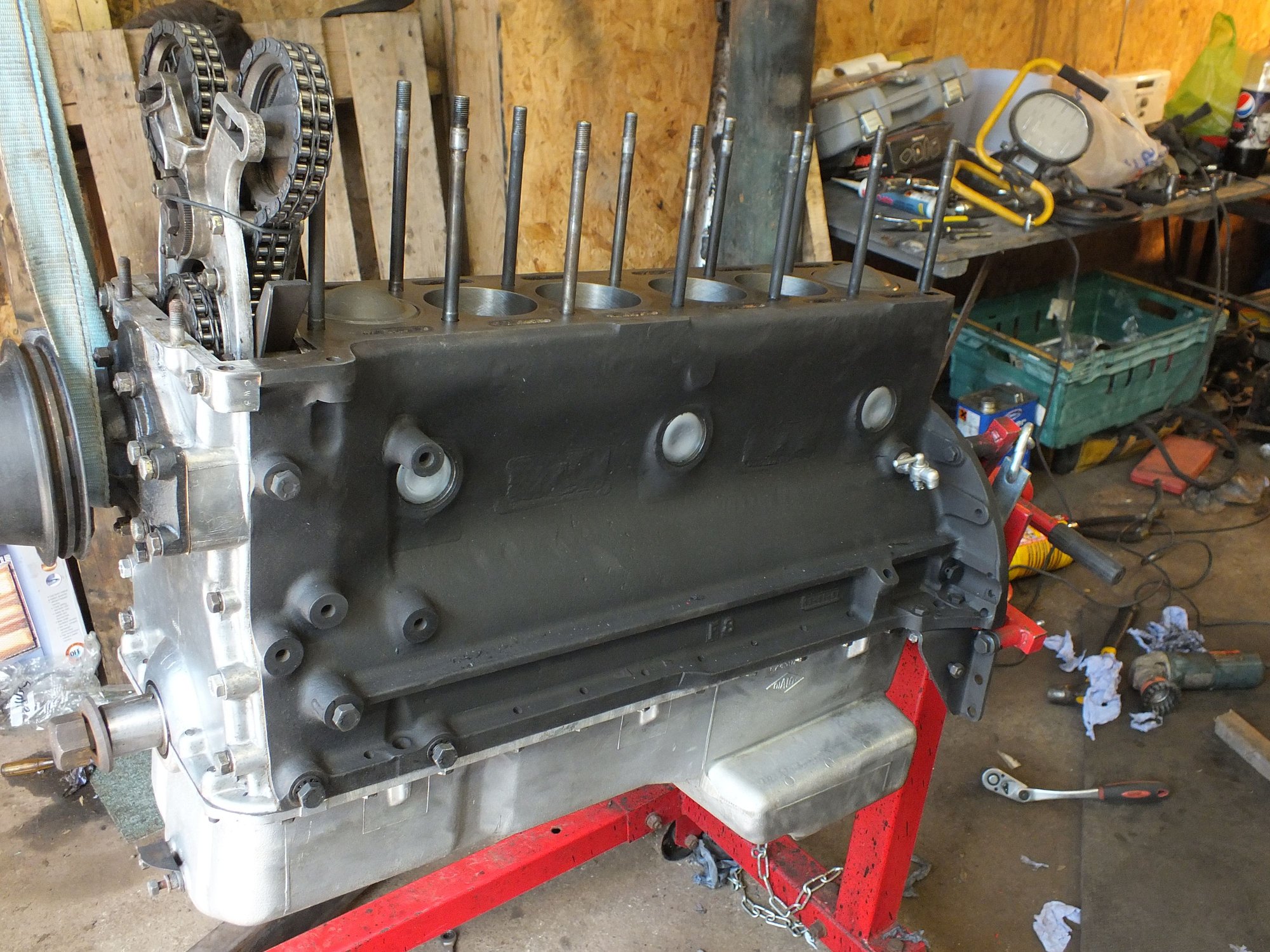

Exhaust side core plugs X3
Inlet side core plugs X3
Rear core plug X1 This was whilst stripping the engine down so old core plug.
This is what you are faced with if you try and do the core plugs with the engine in plus no room due to the inner wing to swing a hammer even if all the exhaust and ancillaries are removed.
