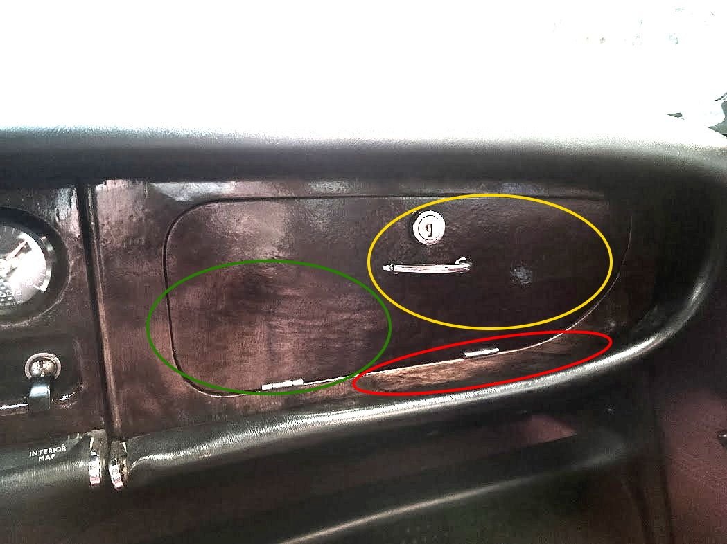

I don't think so, in later cars, the veneer doesn't seem to be as spectacular, but it is indeed walnut, not mahogany.
I've made an attempt to lighten the photo, and the section in green seems OK.
The one in red, may have been sanded through, the grain is not as tight there and is much lighter then the rest of the area.
In yellow is too dark to know what's going on.
Over-all the photo is so bad it's hard to say.

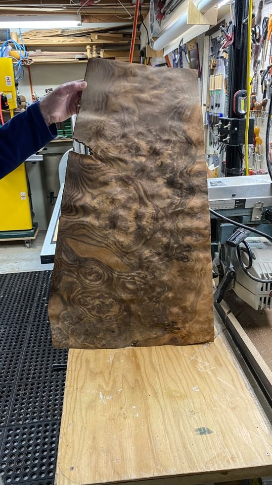

I found that place to be an excellent source of walnut burl veneer.
It's all book matched and you see exactly what you're getting.
I found that it's the only place where they have sizes large enough to do the job.
About veneering, it takes much trial and error to get it right, take a year to teach yourself.
There's lot's of good reading on that sight.

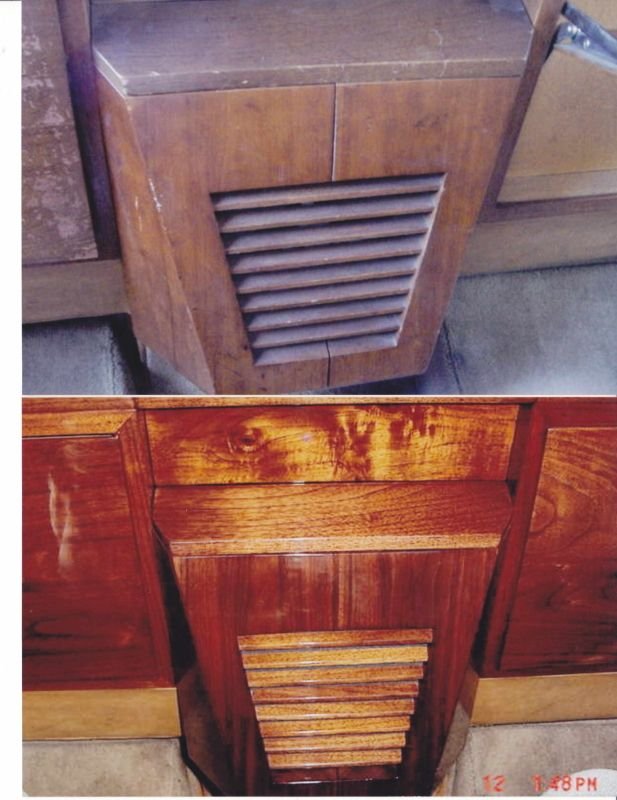

Here are some before and after photos of a guys RR 47 Wraith I did about 10 years ago.
No veneer here to deal with though, it was all solid English Walnut, it was severely faded to this awful yellow.
The centre dash with the gauges on it I replaced because it was warped and some handy-man filled it full of large holes _ too far gone.

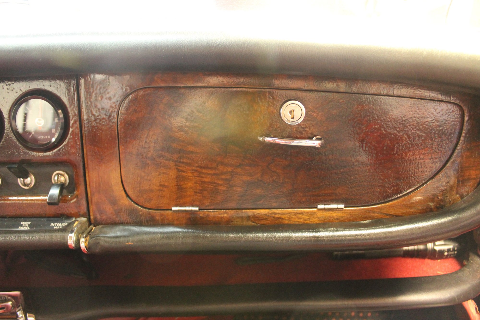

@JeffR1 I took my DSL out to the garage, set the white-balance to Flash, and took some better pictures. I think these do a better job of showing the finish.

Those photos are much better, the glove box lid is fine, it's the bottom edge that's the problem.
Looks like the veneer was letting lose and someone just tore it off, hence the hard jagged edge on the far right; there's also evidence of fill there to smooth things over.
Lots of "fish-eye"_ in that finish, a typical cause of that is silicon contamination in the wood grain, that stuff is a PITA to get rid off.
As soon as a finish is applied in spray form, whether that's from an aerosol can, air brush or spray gun, the thinners in the finish activate the contamination which comes to the surface.
This acts like an oil deposit and causes the finish to creep away in that given area, the finish literally floats on top of the contamination_ it appears as these tiny "pop" marks when sprayed.
Wax trapped in the grain can make this happen too, but it's much easier to deal with.

Better photos of the glove box. The first one was so dark it looked like the wood had been rubbed down and then stained. Now you can see the veneer but Jeff is right someone has torn a section out and tried a repair. Although my wood has some holes in it I have since I built the car purchased some replacement parts in a job lot of spares and I intend to replace the whole dash with the new wood when I get a week so no more holes. The new wood is all matching from the same dash so the veneer looks good. Just have to find the time to strip it all out and replace it.

I don't see anything here that is not recoverable by a good artist that understands woodgrain. Even the chap at British Autowood paints in grain. Then you keep your matching original dash set.

Satin finished by choice. This whole glovebox lid is painted on a friend's car. It came with no lid & he found another non matching one that they started from scratch.

The painting in of the grain isn't as difficult as it sounds especially in the darker area. The lighter parts are more challenging because you don't find that honey gold in a paint pot. I would be more worried by the silicone/wax contamination. That can be extremely difficult to eliminate. And you don't know if you've eliminated it until you apply lacquer.
