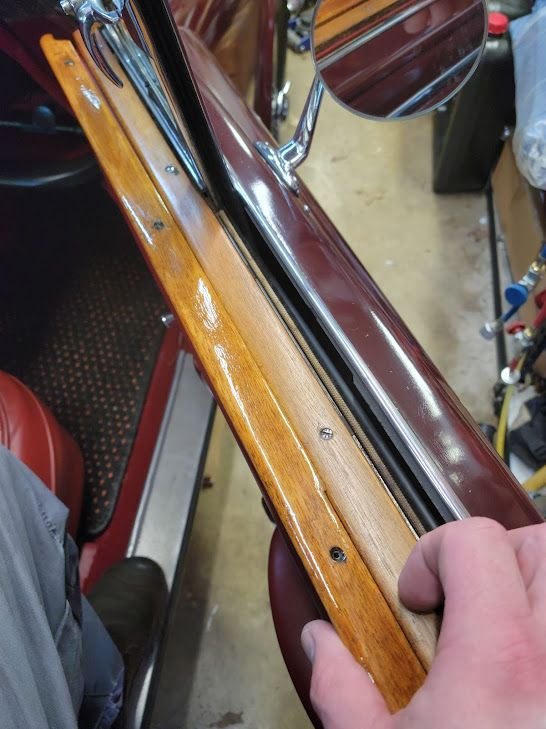

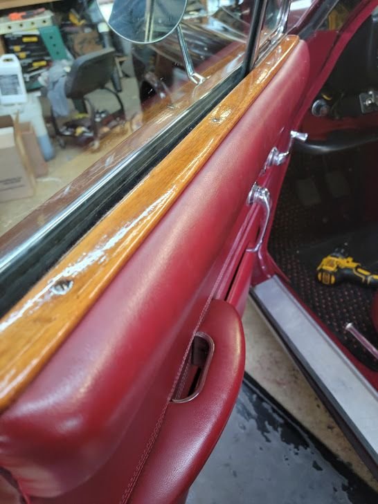

Emboldened by the discussion, I removed the front driver side door piece and stripped off the old finish. I lightly sanded it was some 320 grit then sprayed several light coats of gloss polyurethane. I let each coat dry 24 hours. After the last coat I lightly sanded it was 2000 grit sand paper. I then put a flannel wheel on my low-speed buffer and polished the finish, then gave it a coat of wax.
In the picture below the strip I refinished is on the left, the un-refinished passenger side strip is on the right.
Closer look.
Refinished strip reinstalled on driver's side door.
Thank you to all for the help and great discussion!

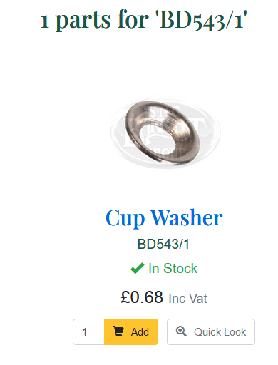

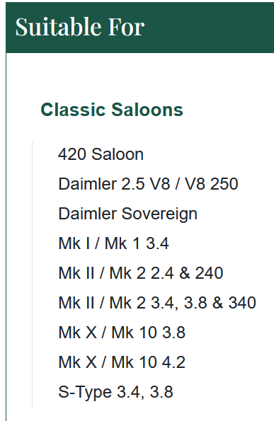

They are small rings that protect the wood from the screw head and help to prevent it sinking into the wood. If you look carefully in the second photo from the top in post no. 12 by Cass, you can see them. Ferrule might be the wrong name. I think it's the cup washer in the link below:
https://www.sngbarratt.com/English/#...up%20washer%60
Old May 4, 2023 | 05:27 PM
  #53
Thorsen's Avatar
Joined: Aug 2017
Posts: 1,587
Likes: 2,826
From: Chicago
Thank you - I will put them in my cart.

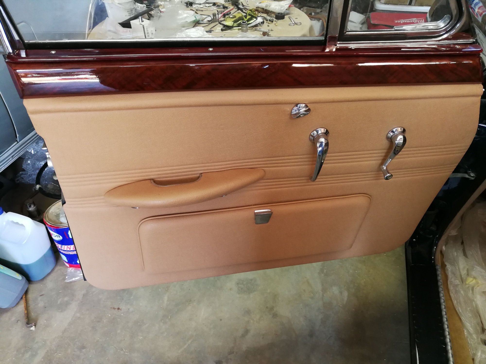

This is them. Early 420's had the full S Type treatment & not just the padded roll & garnish rail.
