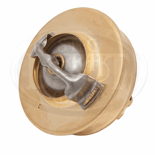

What thermostats are you using? There has been quite a bit of discussion on the XJS forum about that. The main finding is that the OEM thermostats do not extend the "foot" far enough to block off the bypass passage, so the coolant is not forced to go through the radiator. At best, they only move about half the required distance.
You need a different thermostat to fully block off the passage, and when I put them in my 6.0 XJS it made quite a difference to the runnign temperatures. You're looking for a hot distance from the flange to the foot of at least 42mm. I tested some OEM Waxstat's supplied by the dealer and they only extended to 38mm. Some information here: https://www.jaguarforums.com/forum/x...6/#post2089256

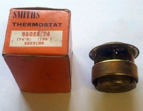

Even on our XK engines the size and position of our bypass slot varies and requires thermostats with different shrouds. Some can be difficult to locate. Fortunately the C3731/1 works a treat on the S type B Type head with narrow slot. Manufactured by Barratts.
C3731/1

I did look at the thermostat Barrants offers, but there is still a fair sized gap between the bore of the intake manifold and the sliding sleeve. I ended up making my own, adapting a "Series" Land Rover thermostat and adding an extra piece of brass such that the gap is less than a millimetre. It seems to work well.
Old Sep 25, 2021 | 09:40 AM
  #40
Glyn M Ruck's Avatar
Posts: 5,546
Likes: 1,493
I measured mine before installation & followed the SA crew with the C3731/1 & it works well & creates enough blanking of the slit, But I do have a tropical radiator with far greater capacity so it's not critical that I get every ounce of coolant to go via the radiator. It is one of the few mistakes in the parts manual ~ picture is correct (90). Thermostat part number is wrong. (conventional thermostat without sleeve). If the slight gap worries you a brass sleeve is available. No idea of the P/N.
For racing they either block the bypass port or fit a plug in the tube with a hole drilled in the centre.
Thermostat is 90 in PM. Sorry I cut off the 90 here.
Sleeve.
