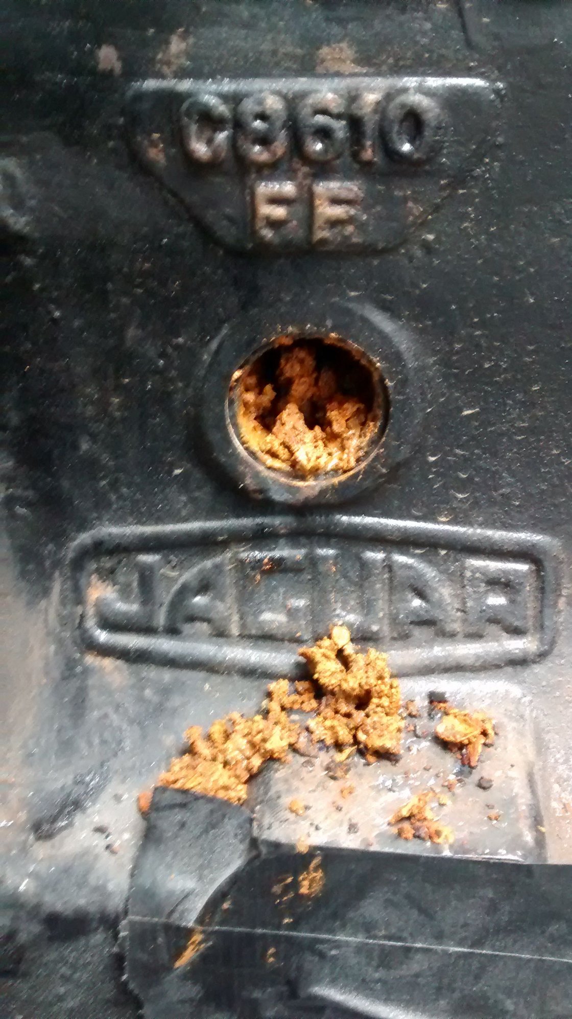

Default XK enigine water channels blocked by rust
How a rusty XK engine looks inside, when you remove the core plugs.

A lot of people complain about old Jaguars over heating and this helps to explain why. The radiator is going to be blocked with that stuff as well.
Fitting a Kenlow fan to this engine is not going to help an awful lot is it which is why I dislike them so much. Fix the true problem first before sticking a Kenlow on your Jaguar.. When new Jaguar engines were not full of this rust and surprisingly did not have an over heating problem.
My engine on strip down was relatively clean but I still found this in the water pump housing and it took several minutes with a high power hose to wash all the crap out of the block.

Yes ~ trying to fix the symptom instead of tackling the core problem is a common trait. If you are doing a rebuild dump the Block & Head in appropriate chemical baths to clean completely.
If not rebuilding ~ depending on severity because there comes a time that the engine has to come apart. Flush your system with citric or acetic acid (vinegar) until the water runs clean. Fill with a modern longlife OAT or HOAT coolant. Be warned that these coolants will further clean the system. If they don't stay clear & bright do another flushing cycle.
